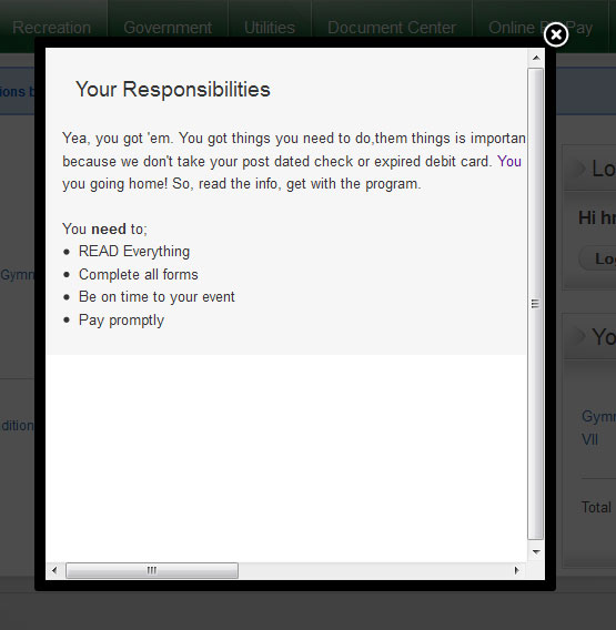

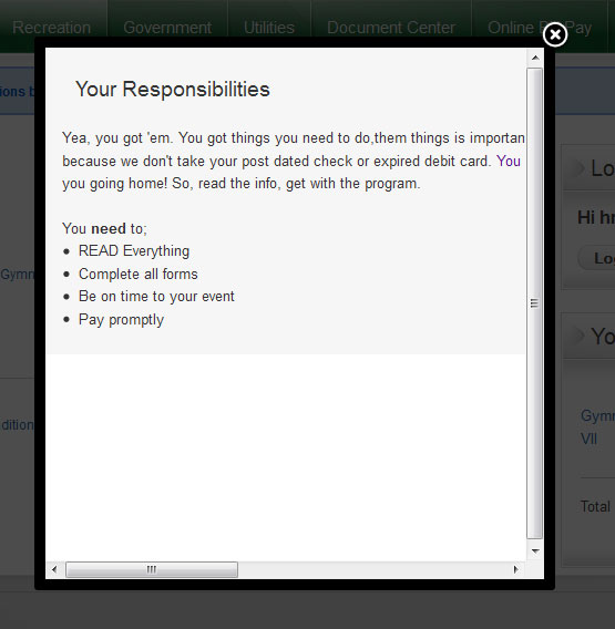

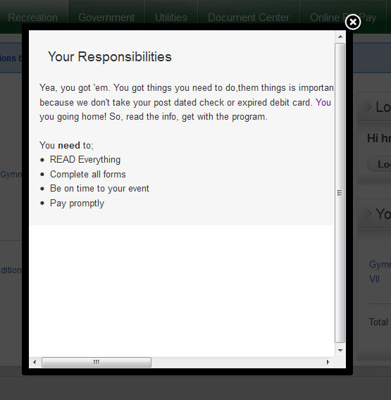

Yep, that works fine. I still have one problem I think is not Hikashop but Joomla. The article I select for my Terms of Service agreement will not display into the lightbox properly. The article requires scrolling sideways to view. I cannot seem to get it to format for the window.
I would think this is a template issue, has anyone else faced this?
Thanks,
DAve

That's indeed a template issue.
That's because in the CSS of the template, the width is set in hard and the component.php file of the template loads that CSS file too.
The solution is to either not load the CSS in that component.php file of your template or to use a copy of the main template css file which doesn't have the width of the page set in hard.
If unsure about how to go with that, you should ask your template provider.

For now, I simply set the text into a table with the width set by pixel and it works.
Thanks,
