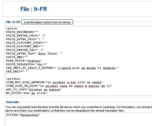

Could you do a screenshot of your modification ?
  • Posts: 19
14 years 7 months ago #35887
here is it
  • Posts: 86179
  • Thank you received: 14214
14 years 7 months ago #35945
That's correct indeed.
Then, it must be joomla translation files overriding that override in some way.
In that case, you should edit the file "filter" for your front end template via the menu Display->Views and directly change the text :
JText::_('FILTER')
by:
'Rechercher'
and that will do what you want.
