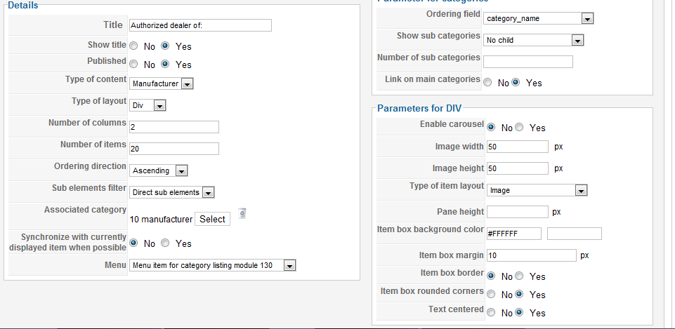

I made a hikashop content display module, where the logos of my manufacturers are displayed on my front end ( arizonatacgear.com/webstore/ ), but when you click on a logo, it gives a 404 error. How do I get it to show all products for that manufacturer?

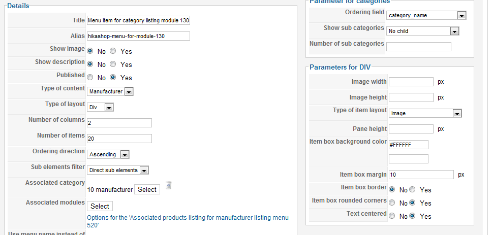

That's probably because your "menu item for category listing module 130" is not set to display manufacturers.
Could you check the hikashop options of that menu for that.

It's set for manufacturer, and I turned off SEF.
