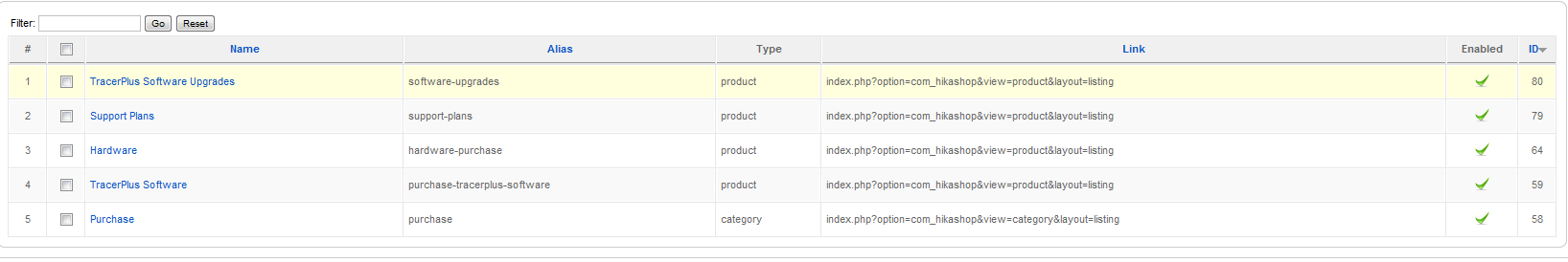

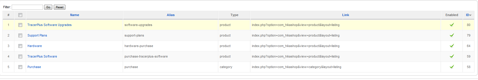

I've attached two screenshots of my content menus and content modules. I only have 1 module enabled, the shopping cart, and that doesn't fix it. In all of my content menus the price is set to display with no tax. Except in the "Purchase" content menu, there that option isn't available, probably because it's a category listing page and not a product listing page.

You should check that option also for the disabled modules. One of them must be used by your menu to display the products listing on your pages.

Aaah, there was one that was set to show with taxes, indeed. Problem solved.
I'm sorry, I didn't think to look in those modules since they were disabled.
