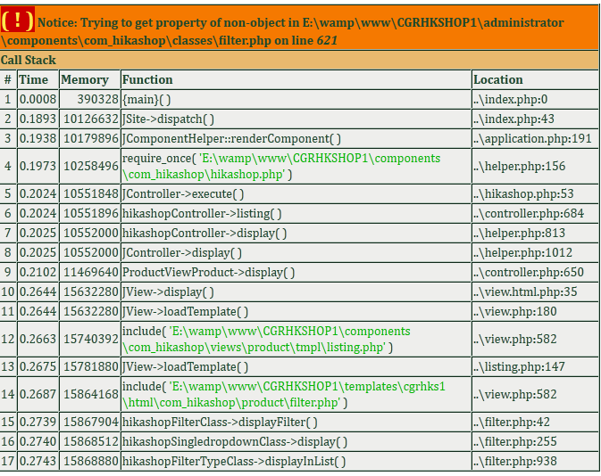

  • Posts: 63
14 years 7 months ago #37273

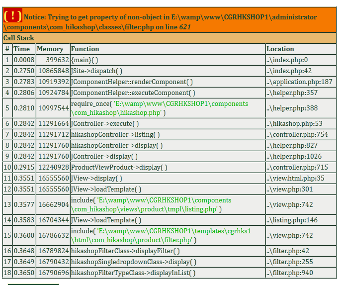

i have a single dropdown filter which i applied on a custom field. here is the error i am getting.
thanks
  • Posts: 86179
  • Thank you received: 14214
14 years 7 months ago #37388
First, please make sure that you're using the latest version of HikaShop (1.5.6) as we made several changes to avoid these errors.

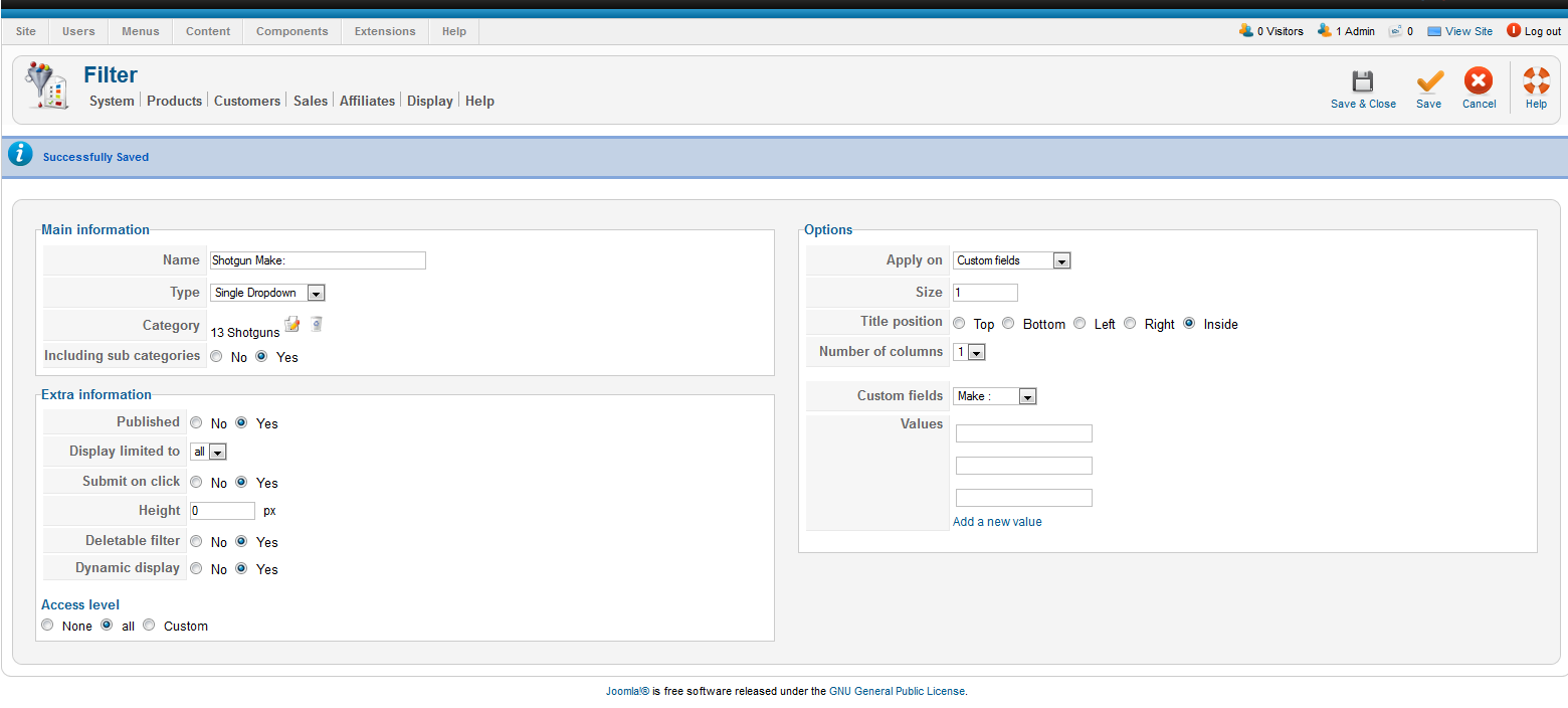

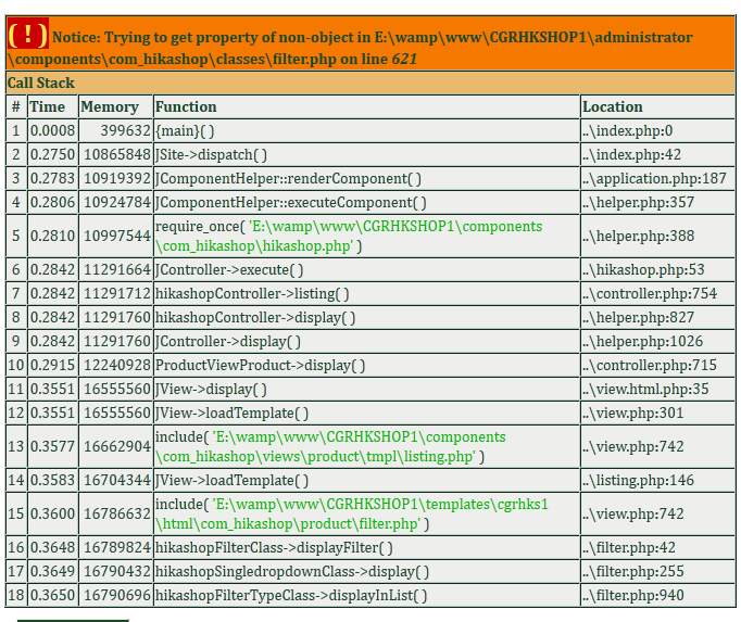

  • Posts: 63
14 years 7 months ago #37456

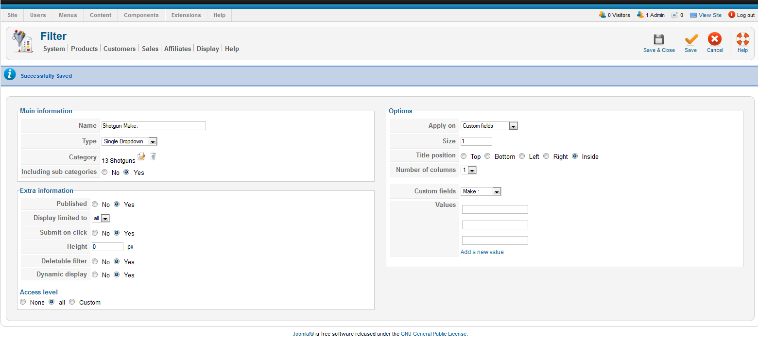

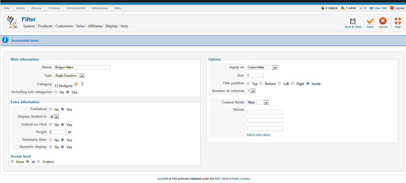

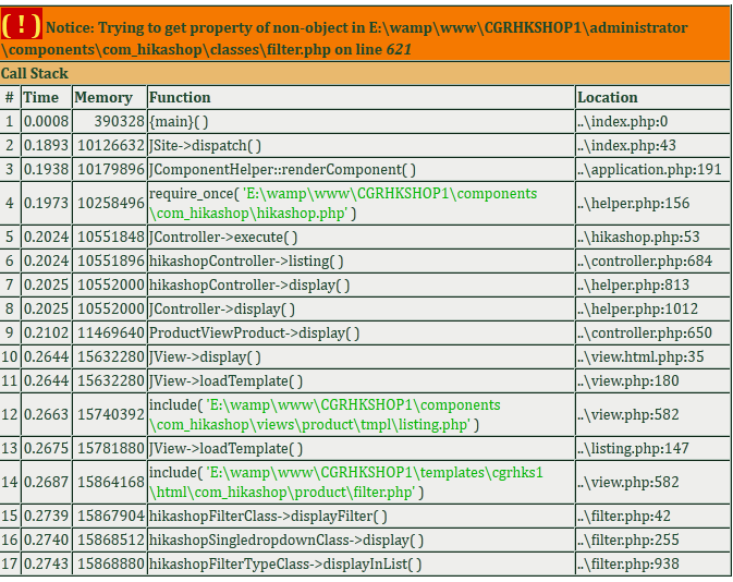

Hi, thanks for the reply. i am using the latest version 1.5.6 with joomla 2.5
here are the screenshots of both filter options and error message at the front end.
thanks
  • Posts: 86179
14 years 7 months ago #37461
Please change the line:
if(is_array($field->field_value)){
to:
if(isset($field->field_value) && is_array($field->field_value)){
in that file administrator/components/com_hikashop/classes/filter.php
and that should not display the error anymore.

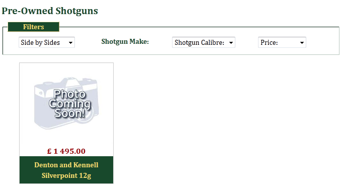

  • Posts: 63
14 years 7 months ago #37472

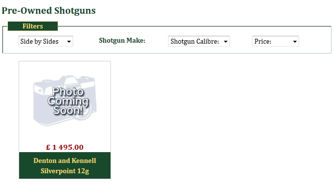

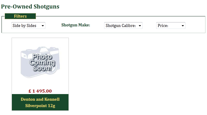

thank you very much for such a quick reply Nicolas. the error msg has gone but just noticed another problem which was also there before we made this change in filter class and is still there. as you can see in the screenshot attached, filter is gone back to its default value instead of showing "Denton and Kennell" and there is no more reset icon with that.
thanks
  • Posts: 86179
14 years 7 months ago #37574
Could you give a link to that page ?
I know that you activated the dynamic option of the filter, so it will only display the possible values for the filter. The error you had meant that there were no value found for the products in the listing.
It's hard to say anything more about that problem without looking at the behavior of your filters directly on the page. But I would say that deactivating the dynamic option of the filter should already help a lot.
  • Posts: 63
14 years 7 months ago #37593
as you can see in the screenshot attached that there was a product falling under the selection i have made. Shotgun type="Denton & Kennell" thats why we have 1 filtered result there. i tried changing Dynamic display to no but the problems stays the same. i am currently working on a localhost and will try to upload the site if you really need to have a look. but i think the information is already enough to reproduce the problem. what do you think?
