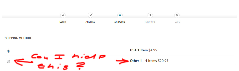

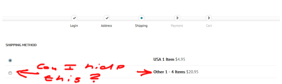

  • Posts: 18
11 years 6 months ago #190916
I have the same problem... I have special shipping Zones for USA, Canada / Mexico. And the "Rest of World" have one zone.
I defined the shipping methods which were linked with zones (USA and Canada / Mexico). And I also defined a shipping method which is not linked to any zone (which is the most expansive method).
I thought that the system will checkout the cheapest shipping method and use this for checkout.
The system did that but it also displays the method for the "Rest of World" as an option. That is very confused for a customer. Is there a possibility to say the system that it only displays the cheapest shipping method?
How can I solve that problem with shipping methods for two zones and one for the rest of world!
woonydanny had the idea to create an own zone for rest of the world... but to create an own zone for "Rest of World" would be very complicated because I have to type in all the 2 letter codes for hundreds of countries!?
Please help,
FRank
