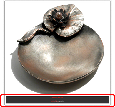

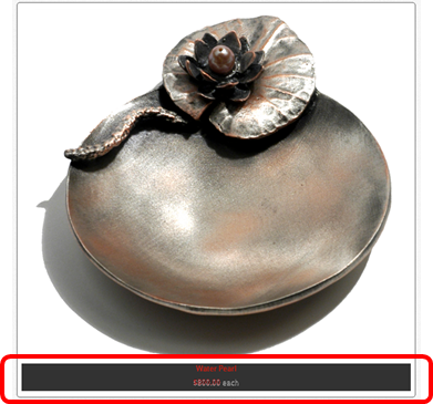

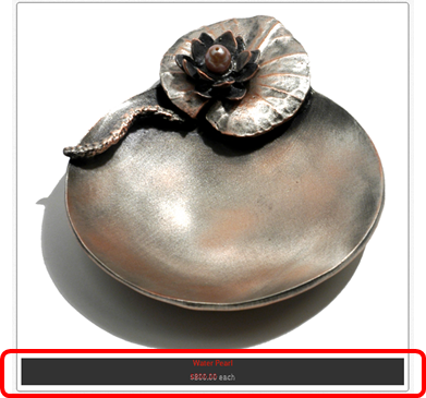

How to change the color or remove the pane marked in red box below:
Last edit: 14 years 7 months ago by sdhakad.
  • Posts: 86112
  • Thank you received: 14210
14 years 7 months ago #38294
That black area displays because you're using the pane item box layout in your menu/module's hikashop options.
You can use another item box layout to not have it.
Or you can change the CSS of HikaShop to change it's color. The CSS code would be:
.hikashop_img_pane_panel{
background-color: white !important;

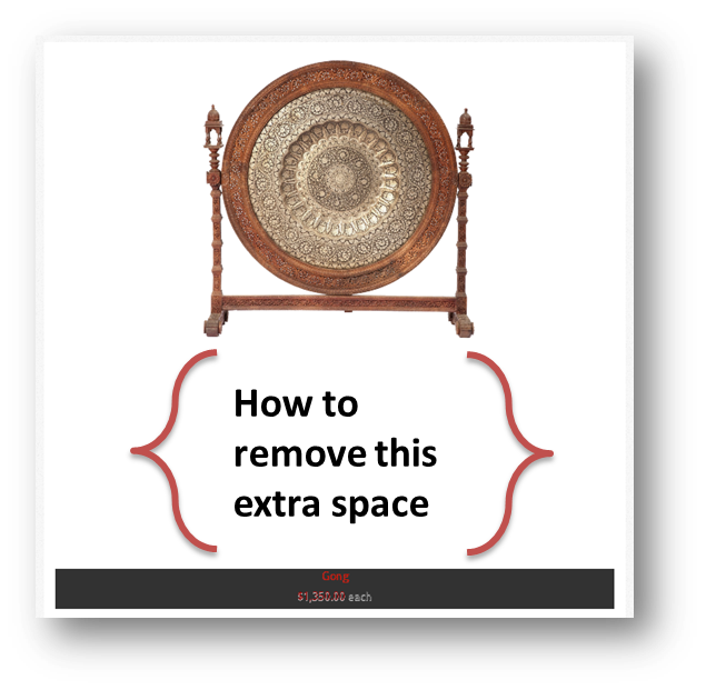

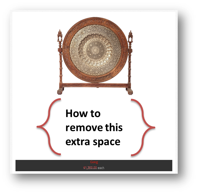

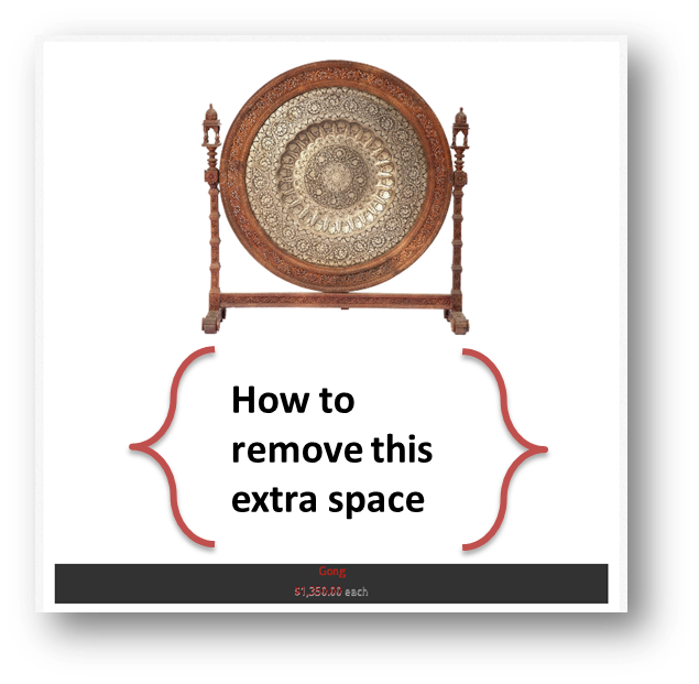

Thanks for the quick reply. Some more help needed, please:
1. How to remove the extra space between the product photo and the black pane. i am not able to find it in CSS.
2. As advised, where can i find to choose another item box layout.
Thanks in advance.
  • Posts: 86112
14 years 7 months ago #38508
For the space, that must be because of the "Pane height" option in the hikashop options of your menu/module.
The hikashop options of your menu/module can be accessed by editing the menu/module via the menu Display>Content menus/modules in the back end of HikaShop.
