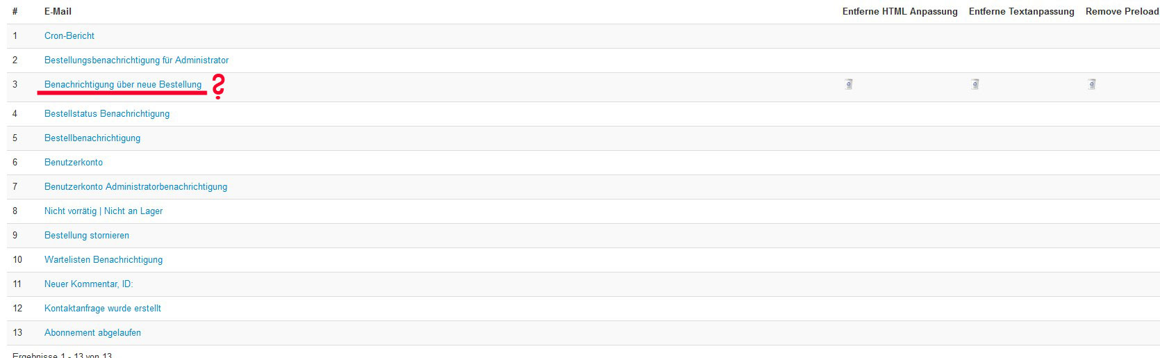

  • Posts: 33
12 years 5 months ago #141191
I chose the 3rd one (screenshot) in intention to add the product code to the order notification Email like that:
old version:
<?php echo JText::_('CART_PRODUCT_NAME')."\t".JText::_('CART_PRODUCT_UNIT_PRICE')."\t".JText::_('CART_PRODUCT_QUANTITY')."\t".JText::_('HIKASHOP_TOTAL');?>
new:
<?php echo JText::_('CART_PRODUCT_NAME')."\t".JText::_('ORDER_PRODUCT_CODE')."\t".JText::_('CART_PRODUCT_UNIT_PRICE')."\t".JText::_('CART_PRODUCT_QUANTITY')."\t".JText::_('HIKASHOP_TOTAL');?>
was that the right way?
  • Posts: 85786
  • Thank you received: 14079
12 years 5 months ago #141243
You're looking at the text version of the email.
Since a few versions, the HTML version of the emails uses a templating system so the code is totally different from what you have written here.
But it's even simpler. You just have to add the tag {LINEVAR:PRODUCT_CODE} after the tag {LINEVAR:PRODUCT_NAME} and you'll get the product code after the product name in the email.

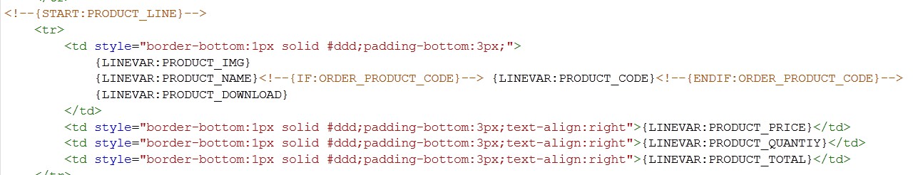

  • Posts: 33
12 years 5 months ago #141262
in the order notification email I found already that tag... (screenshot)... so it´s right?
12 years 5 months ago #141307
A solution can be to change this line :
{LINEVAR:PRODUCT_NAME}<!--{IF:ORDER_PRODUCT_CODE}--> {LINEVAR:PRODUCT_CODE}<!--{ENDIF:ORDER_PRODUCT_CODE}-->
By :
{LINEVAR:PRODUCT_NAME}            {LINEVAR:PRODUCT_CODE}
  • Posts: 33
12 years 4 months ago #141413
sorry, but the product code is still not seen in the Email... and I just got told that the coupon code is also not seen, only that a coupon is used.
  • Posts: 33
12 years 4 months ago #141638
the problem is still not solved and I would please need a solution.
In the notification email that I get after an order should be also seen:
the order number
the product code
and if the case - the number of the coupon
which file (a screenshot would be helpfull cause I have the german version :( ) do I have to edit and how? I have not enough knowledge of html or php so I am quiet helpless.
thanks
Last edit: 12 years 4 months ago by medean. Reason: wrong pic
12 years 4 months ago #141725
Sorry for the late reply. Can you tell me in which email you're checking that the product code is displayed ? (Order creation notification/Order administrator notification/Order status notification).
Can apply the modifications that I gave you through these 3 emails and tell me if your product code is displaying ?
