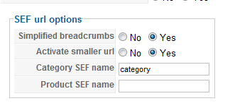

  • Posts: 30
14 years 7 months ago #39112
That does work, although if I remove the 'products' part the products 404
www.code7dev4.co.uk/online-store/1074-au...rastructure-modeller

  • Posts: 30
14 years 7 months ago #39127
have 'category' in the category box...
Last edit: 14 years 7 months ago by code7. Reason: added screenshot
  • Posts: 86179
  • Thank you received: 14214
14 years 7 months ago #39214
Maybe you need to flush the SH404SEF URL cache. I know that sometimes it can be off and thus break URLs like that.
If that doesn't solve the problem, then I don't know. From what I can see in the code, I don't see a problem on that end for HikaShop.
