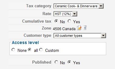

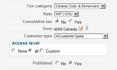

I have a very simple tax setup as I learn about shopping carts:
1. Just one tax category and that category is chosen for all products.
2. Just one tax zone Canada
3. HST tax rate of 12%
4. Just one tax rule (see attached)
I have read the documentation and forum searches several times, but I cannot see why the taxes are not showing up on the checkout page or on the order emails and invoices. I think I have done everything mentioned in the documentation!

The problem you had was simple:
You don't need to create a tax zone for Canada.
You can and should directly use the existing Canada country zone in your tax rule.
As you created and used another zone that the country zone for your tax rule, the system didn't know that the canada tax zone and the canada country zone were related, so the tax wasn't applied.
By using the default Canada country zone in your tax rule you indeed solved your problem.

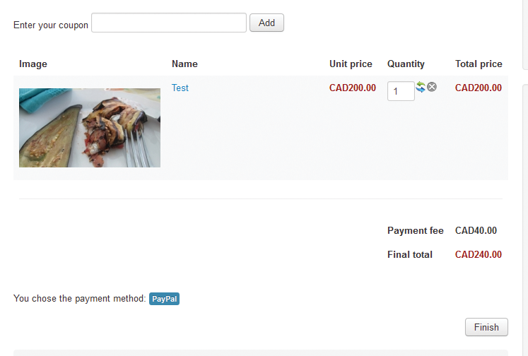

  • Posts: 6
12 years 10 months ago #128850

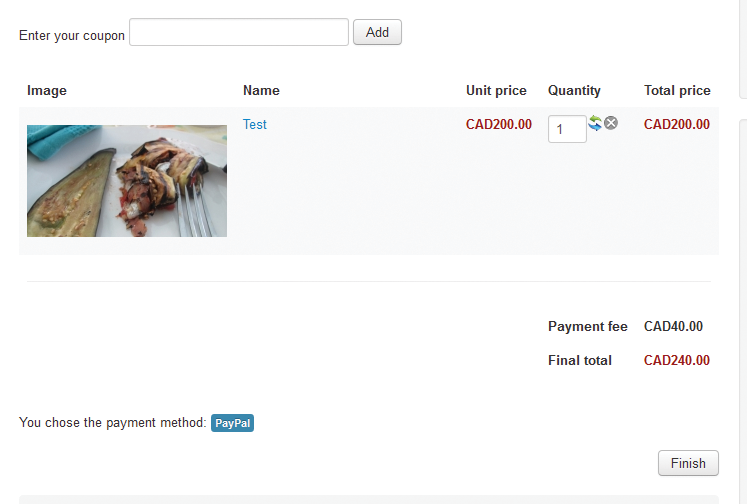

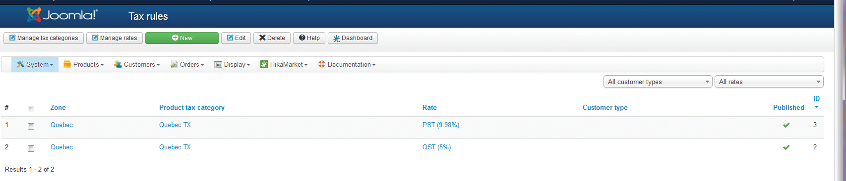

I am trying to setup the taxes but they are not showing.
I am wondering if this is related to a weird situation where I originally put 20% payment fee earlier and then changed it to 15%, it's still showing as 20 at checkout
  • Posts: 6
12 years 10 months ago #128853
When setting up a cost, Price with tax matches the original cost.
12 years 10 months ago #128869
If you have correctly changed your tax value (can you show me screenshots of your tax configuration page ?), can you clear your cache and try it again ? Then tell me if you have a 15% payment fee.

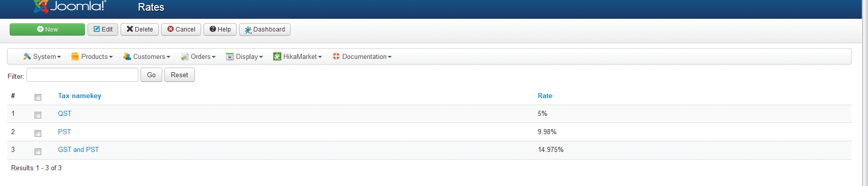

  • Posts: 6

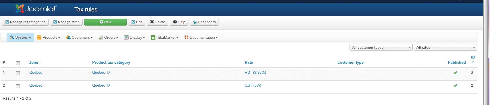

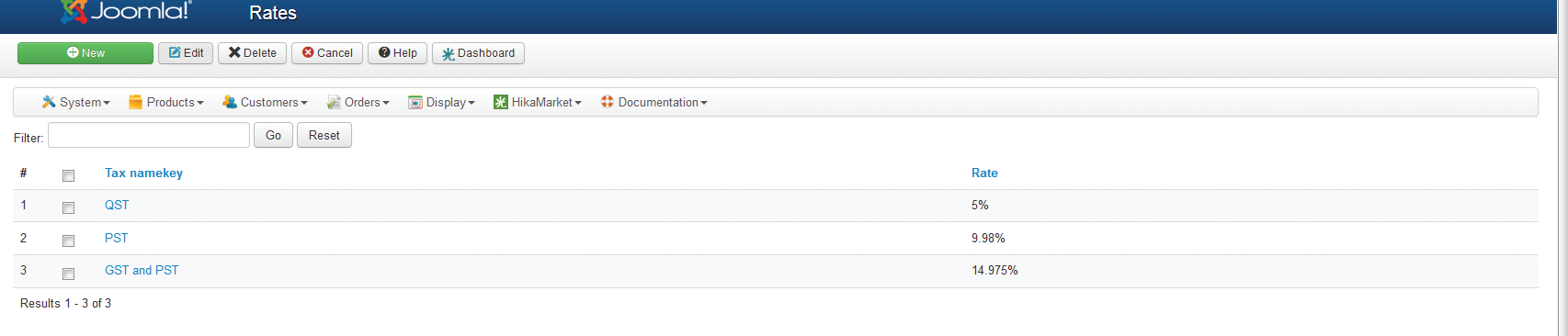

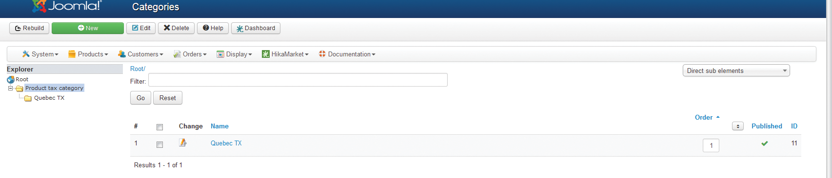

12 years 10 months ago #128945
Here are my settings and result, I might have forgotten a detail
  • Posts: 86106
  • Thank you received: 14206
12 years 10 months ago #129272

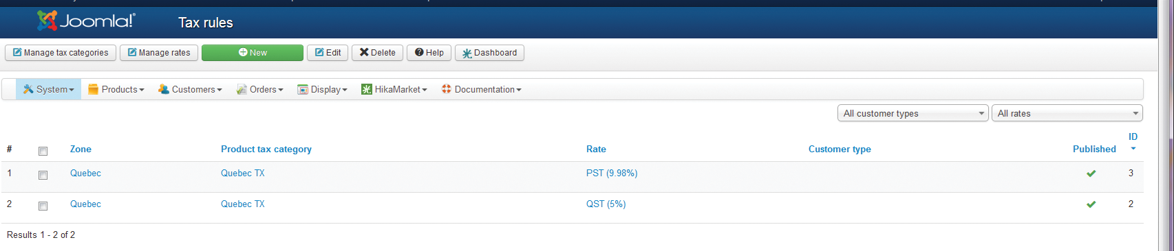

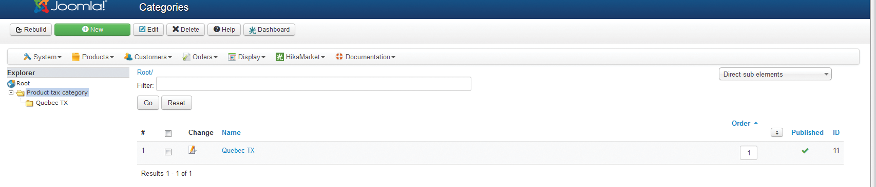

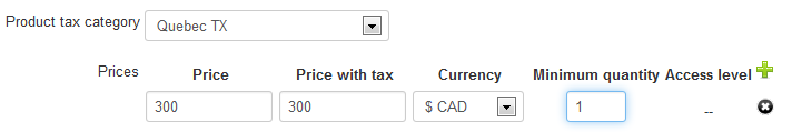

You need to make sure that you selected the "Quebec TX" tax category in your products (when you edit them). Otherwise, the tax rules won't apply to them. Also, as you have two tax rules that you can to be applied at the same time, you need to have the "cumulative" option of your tax rules turned on.
  • Posts: 6

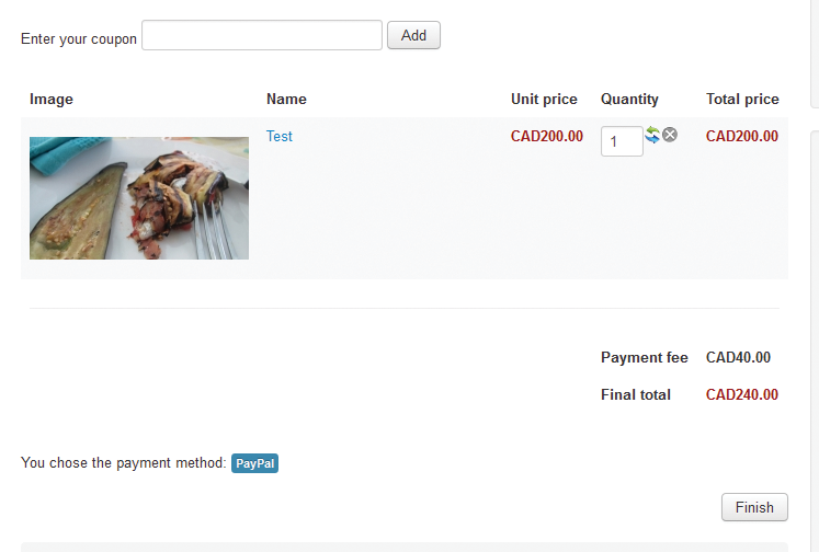

12 years 10 months ago #130635
Thank you for the reply. But look what happens, taxes are not applied

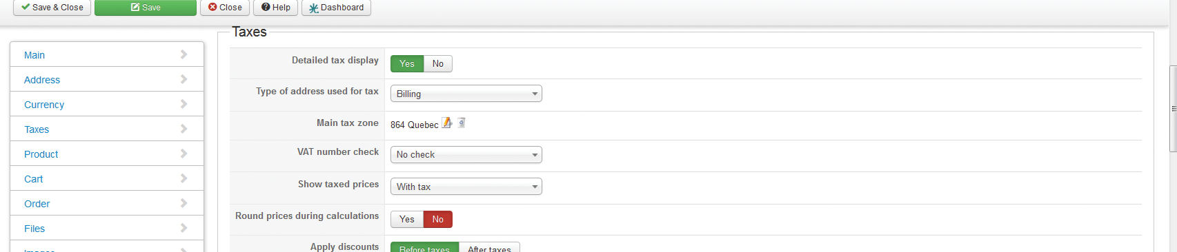

  • Posts: 86106

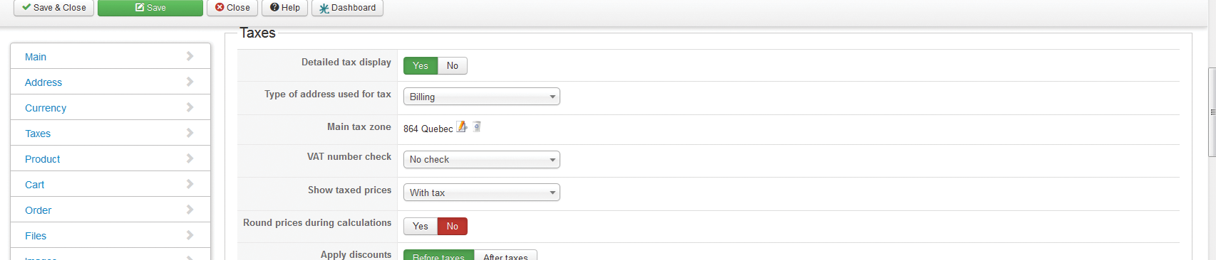

12 years 10 months ago #130653
This is a screenshot of the backend. Taxes will only apply on the backend if the product's tax category is set to the tax category of your tax rules and if the "main tax zone" option of your hikashop configuration is configured to the zone of your tax rules and/or your user's default address is configured to the zone of your tax rules.
Since that's not the case in your screenshot, it means that one of these things is not configured like it should.
