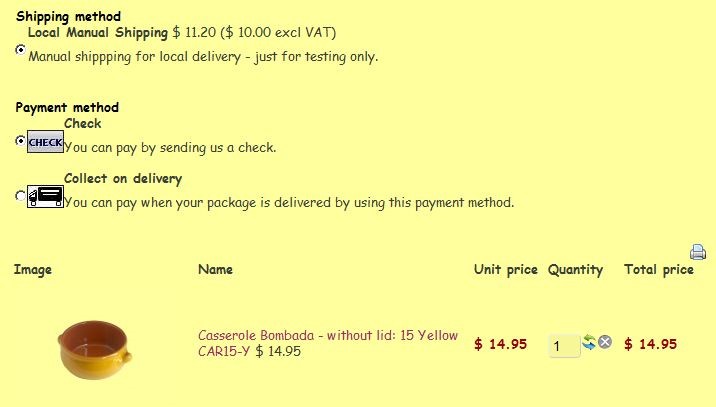

Referring to the capture below:
1. How can I remove the ($10 excl VAT) addition to the shipping cost. It is not relevant here

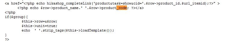

2. I modified the code to show the product_code
and as far as I can see that is the ONLY code change I made. But an additional price is showing up after the code.
Please could you tell me why the extra price is there and how to correct that error.
Jim

1. You should edit the file "shipping" of the view "checkout" via Display>Views and remove the code:
echo JText::_('PRICE_BEFORE_TAX');
								echo $this->currencyHelper->format($rate->shipping_price,$rate->shipping_currency_id);
								echo JText::_('PRICE_AFTER_TAX');
2. You should remove that code too:
if($group){
										$this->row=&$row;
										$this->unit=true;
										echo  ' '.strip_tags($this->loadTemplate());
The following user(s) said Thank You: Jims

In case others need this, the second code change is in the "cart" file of the view "checkout"
The first edit makes sense, now. But I don't have enough php experience to understand how adding product_code affected that "if" statement.
Jim

It didn't. I don't know why you had that problem as we don't on our end. However, that modification was the easiest to solve the problem.
