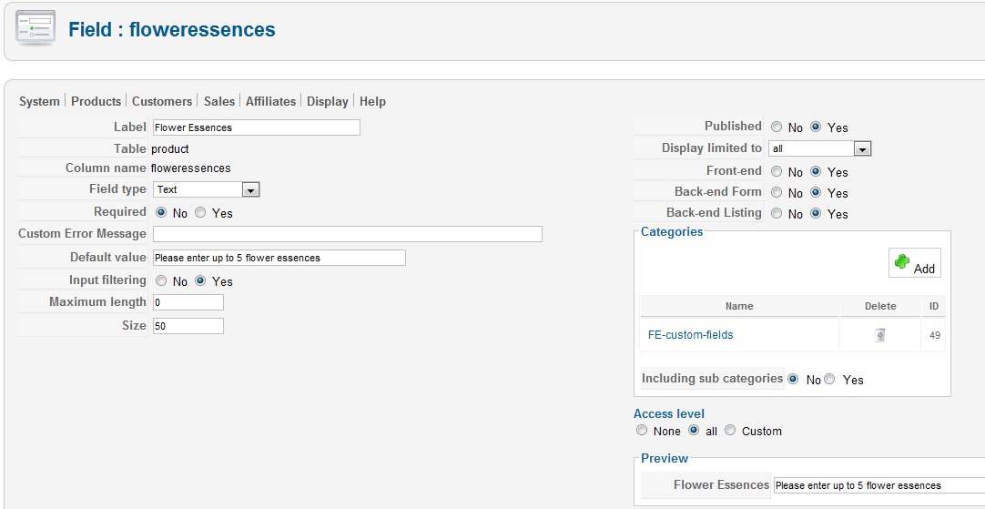

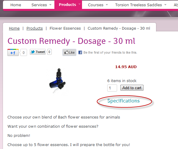

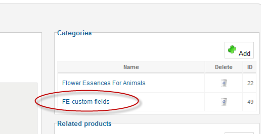

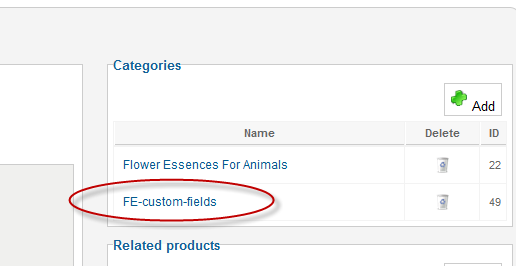

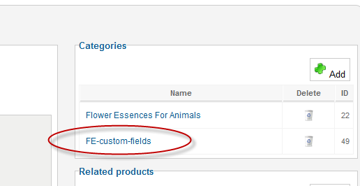

  • Posts: 80
14 years 6 months ago #40008
Hi Nicola,
I've done what you said but it's not working.
On the product page, it only displays the word Specifications
I've attached the screen shots

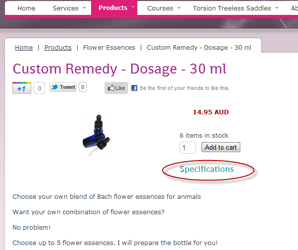

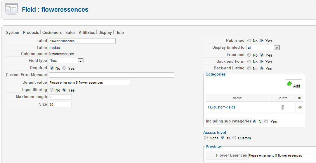

  • Posts: 80
14 years 6 months ago #40107
I've changed the custom fields to apply to the category and it's still not showing up
can you have a look at it please?
thanks

  • Posts: 86177
  • Thank you received: 14212
14 years 6 months ago #40214
You created a custom field of the table "product" which displays on the product edition interface.
I told you to create custom fields of the table "item" so that it displays on the product page.
That's why you don't see it ;)
