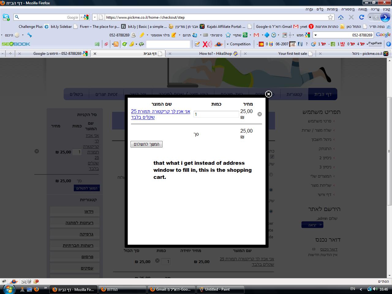

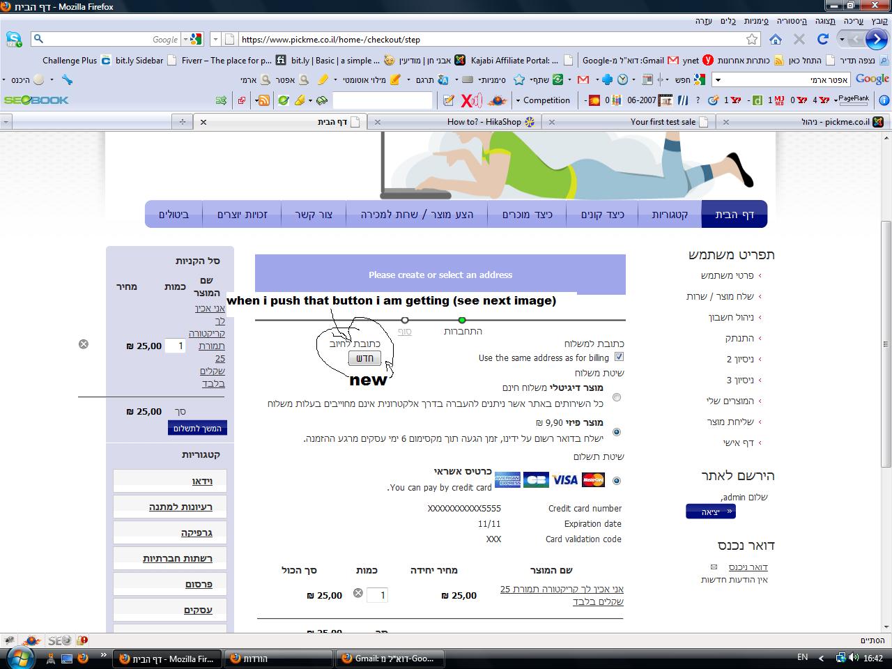

hi,
when i am trying to add an address and i am clicking on the button of the new address the window that open to me its the shopping cart and not the address window.
Last edit: 15 years 7 months ago by nicolas.

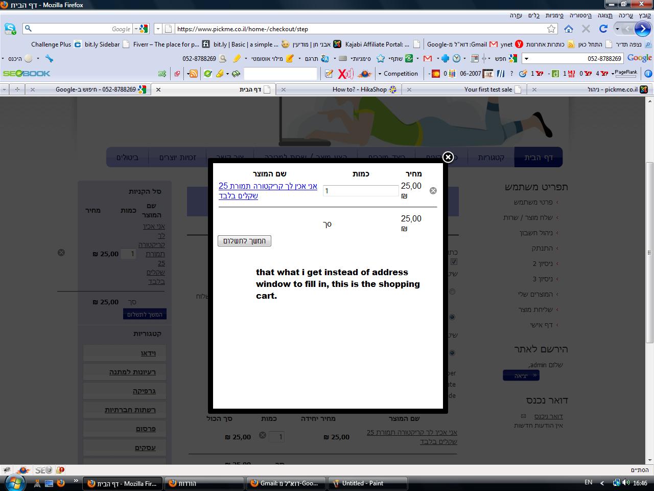

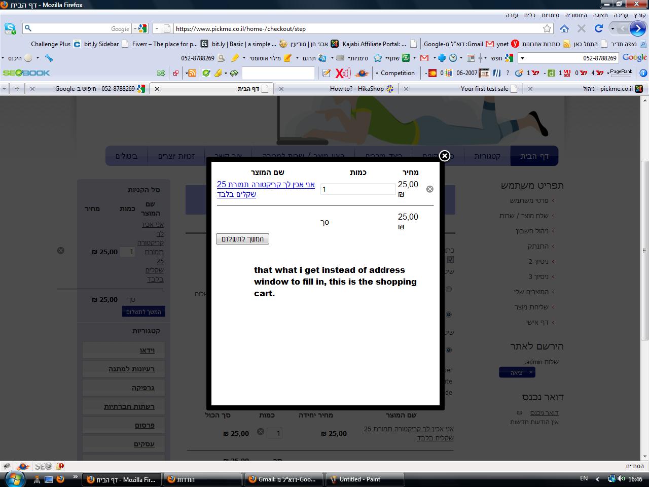

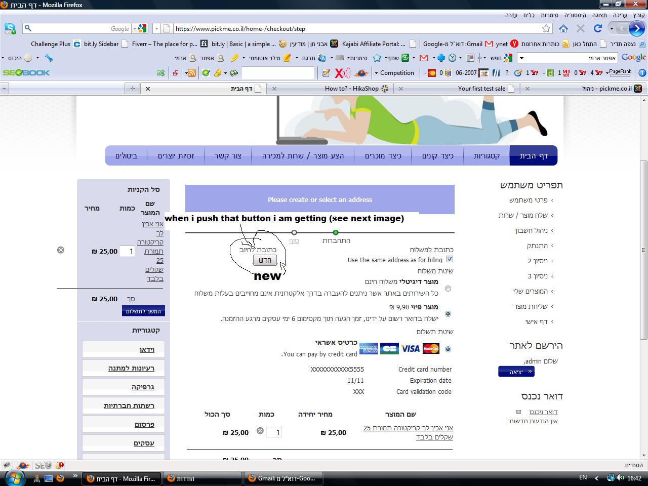

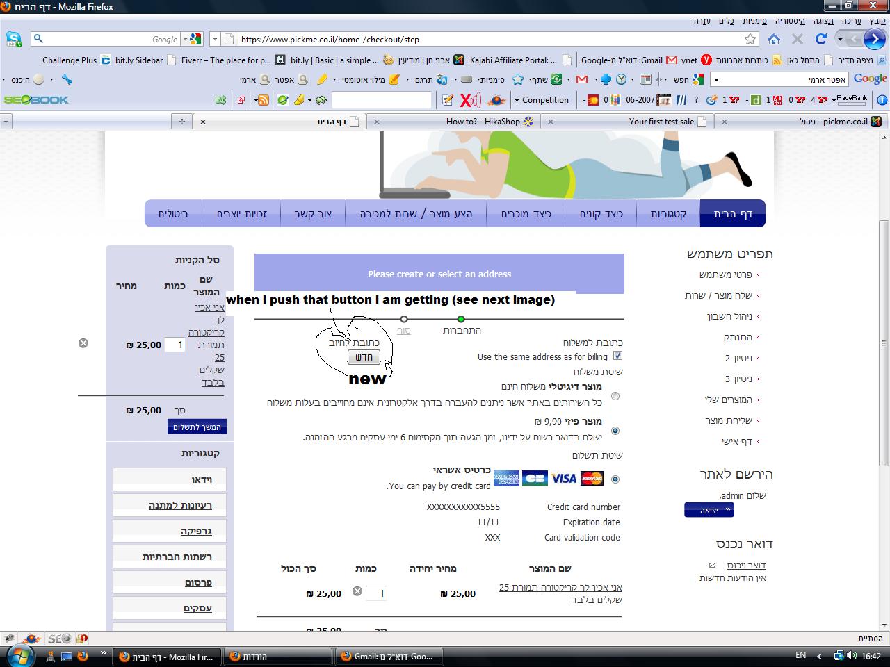

15 years 7 months ago #3999
the other pic
  • Posts: 82
15 years 7 months ago #4000
please remove the pics after you will see them.
