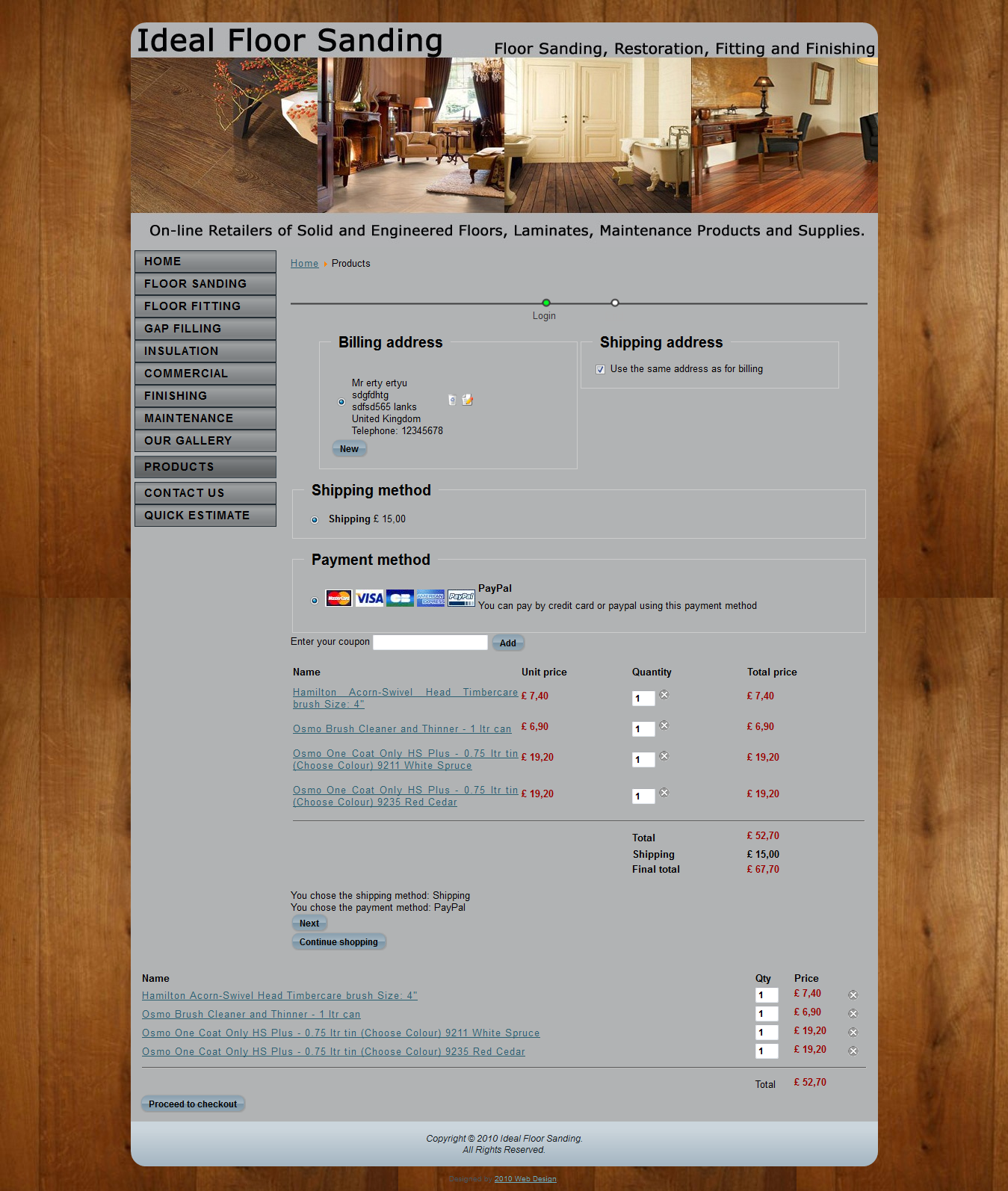

Hello I am enjoying this shopping system and I have loaded many products to my soon to be live shop, I do have a view to upgrading but at the moment I have a problem.
When you click from the shopping basket to the payment, a log in is required, once loged in the shopping basket list with total and pay now are displayed that all fine,
but underneath is the same list with a continue shopping button, how can I remove it from this page as it make the payment page confusing.
I have set the basket to show at the bottom of the page while they shop as it looks odd sitting at the side and I do not like it at the top of the page.
I hope I have explained this ok
Arthur

Hello I have now added a screen shot, I hope this helps, with my explanation

You should set the option "force a menu on checkout" in the Checkout tab of the configuration with a specific menu.
Then, in your hikashop cart module's options, assign the module to all the menus except that one. Then, the module won't display on the checkout.

Thanks for your reply, I have already forced the card to products page, so it only shows in that part of my website.
I have had a look at the mode and and it shows the pages to select, the products option I have selected, but there is no sub sections as products is the whole shop.
Yours arthur

If you don't set the option "force a menu on checkout" in the Checkout tab of the configuration with a specific menu, the checkout will also be on your products pages menus. That's what you still saw the module on the checkout.
