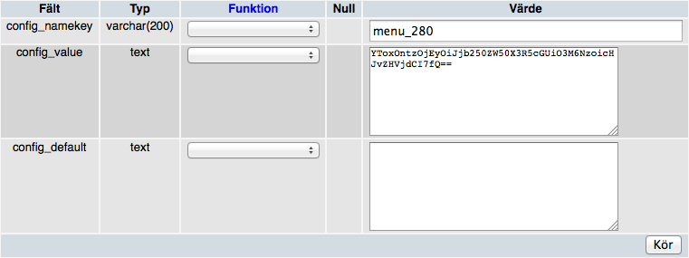

In the attachement you'll see the value that has been entered. Is this normal or should it be something readable?
All my menues have the same content in the table _hikashop_config and I can't save anything to this table.
