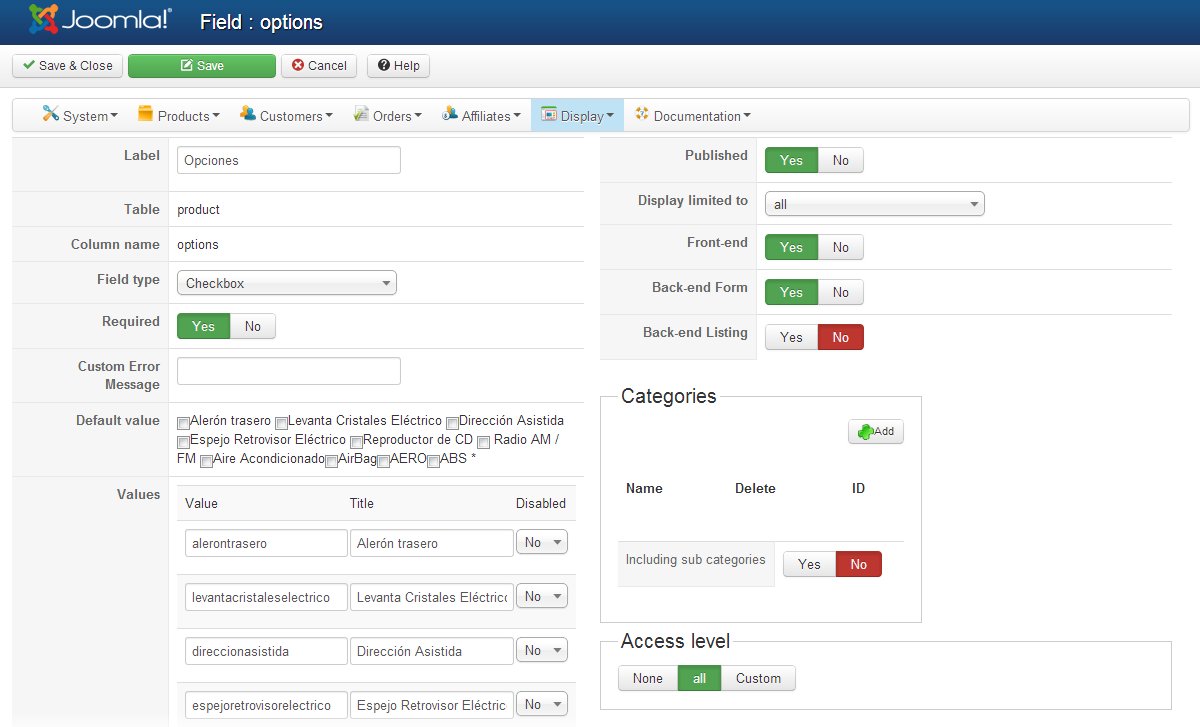

  • Posts: 13
13 years 4 months ago #99774
Sorry for my poor English.
Well... when I add a product and check some items of the "Check List" like the image below
checks disappears after saving the product.
Best regards.
Mirai

  • Posts: 86112
  • Thank you received: 14209
13 years 4 months ago #100603
The problem comes from the column name of your custom field.
Please change it to something else and it will work.
options is used for storing the options of your products so HikaShop will overwrite it and thus it won't save your selection.
