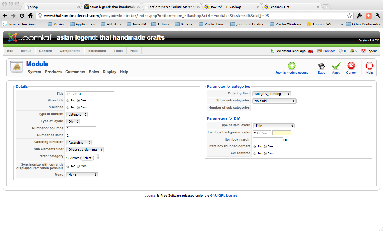

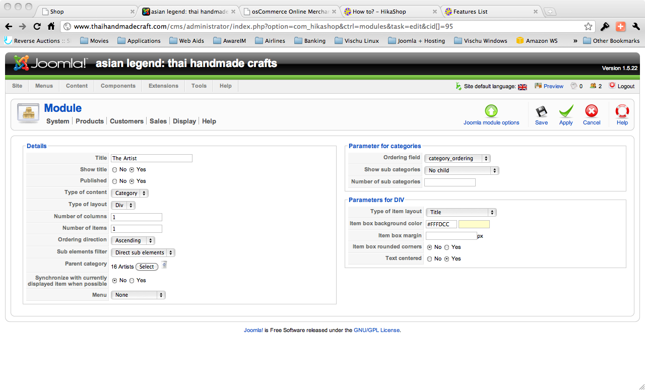

I recently purchased the Business version of Hikashop and after playing with it for a couple of days, I am very happy with the possibilities.
However my client's shop sells art and on each product page they want to show the artist of the product and other products by the same artist. I thought I had this working, but unfortunately the artist that is shown is the first artist from the database and not the artist of the product. Showing the other products of the same artist works fine.
I am using the module that is shown in the picture to achieve this. I also tried to set the synchronize option to yes, but then nothing is shown on the product page.
Any help would be greatly appreciated.
Gert.
  • Posts: 86058
  • Thank you received: 14182
15 years 7 months ago #4156
It's indeed not possible to show a category syncrhonized with a product. In such case the system will use the parent category and display a listing its subcategories.
What you could do is create a custom product field (menu Display->Custom fields) of type single dropdown and with the values being the artists. Then, for each products, set that custom field and it will appear on the product page. You'll probably want to change the default "Specifications" text by something else or remove it by editing the translation file in the configuration under the tab languages.

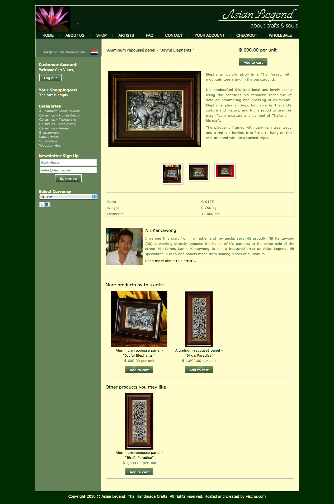

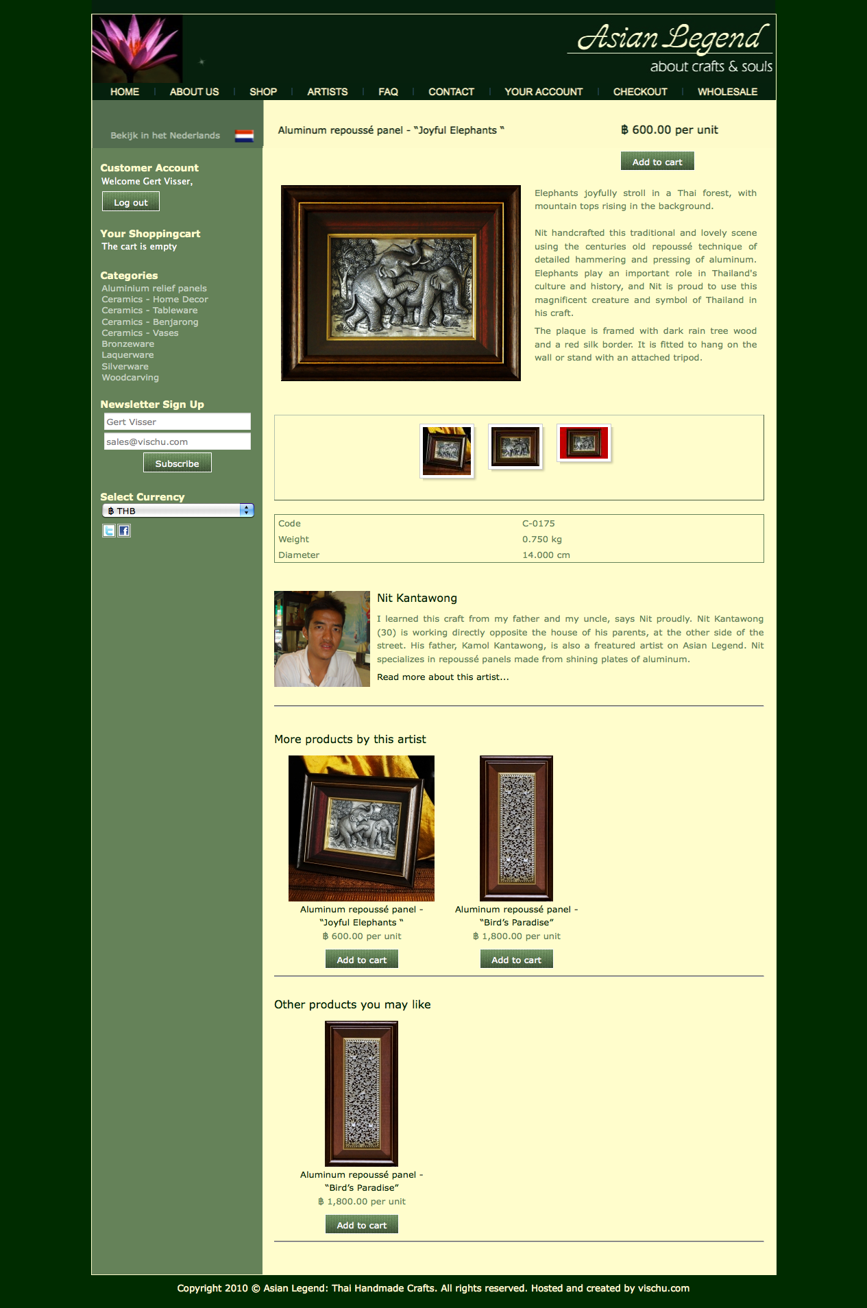

Nicholas,
In addition to my previous post, I need to show the artist picture and a description as shown below. I believe this is not possible with a custom field as there is no custom field type picture.
Any other suggestions on how I could achieve this?
Gert.
  • Posts: 86058
15 years 7 months ago #4164
What we can do is modify the code a bit to display a listing of the categories of the product when the module is syncrhonized and on a product page.
But that's not what you want either as I understand since you want to somehow map a category in a list of categories with a product...But the system doesn't know how...
For your second question: you can create two custom fields.
One with the URL of the image and the second with the description and not display them on the front end.
Then, you can edit the file show of the view product via the menu Display->Views and add a few lines of code to display them the way you want. You will find their data in the variable $this->element->FIELD_COLUMN_NAME where FIELD_COLUMN_NAME is the column name of the field.

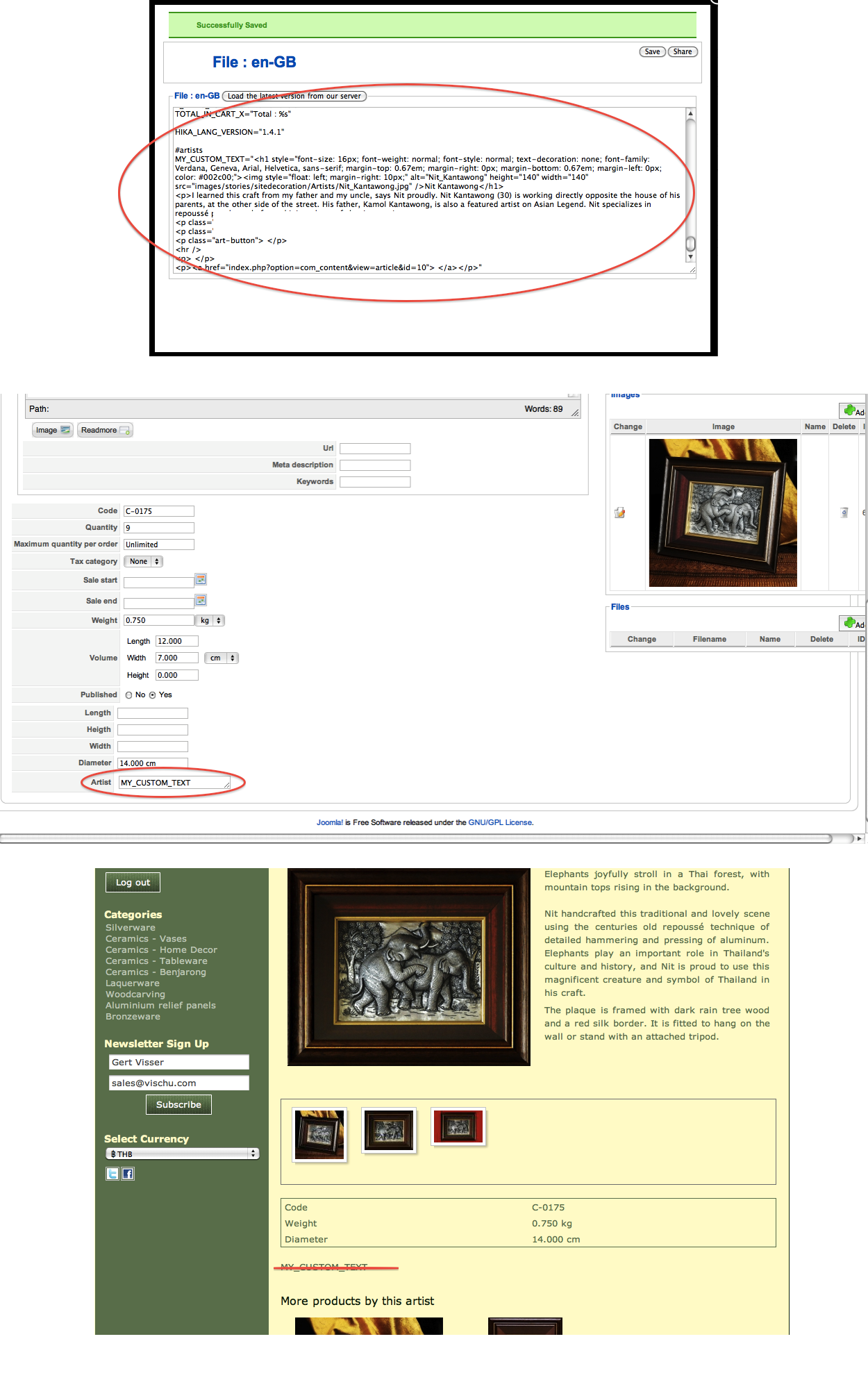

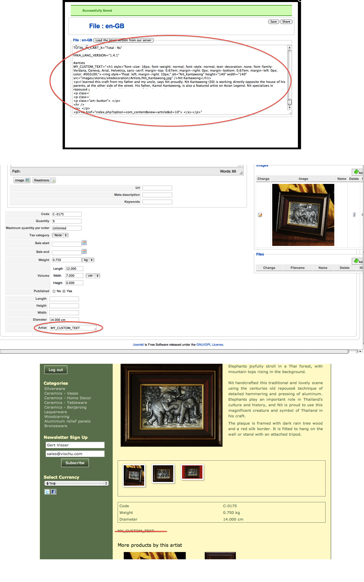

Hi Nicholas,
I followed your suggestion. This is what happens.
Did I do anything wrong?
Gert.
  • Posts: 86058
15 years 7 months ago #4370
Yes. In joomla translation files you can't use quotes as they are used to delimit the translation strings.
You need to use simple quotes instead. Otherwise, joomla will discard the translation.
  • Posts: 86
15 years 7 months ago #4371
Nicholas,
All the translation strings start and end with ".
As a test I tried both the following:
MY_CUSTOM_TEXT='Nit Kantawong'
MY_CUSTOM_TEXT="Nit Kantawong"
In both cases the product page still shows MY_CUSTOM_TEXT
Gert.
  • Posts: 86058
15 years 7 months ago #4372
I just tried on my end on our test websites and it's working fine with your example:
Are you sure that you don't have other lines that you added in the translation file with double quotes within them which would break the translation file ?
