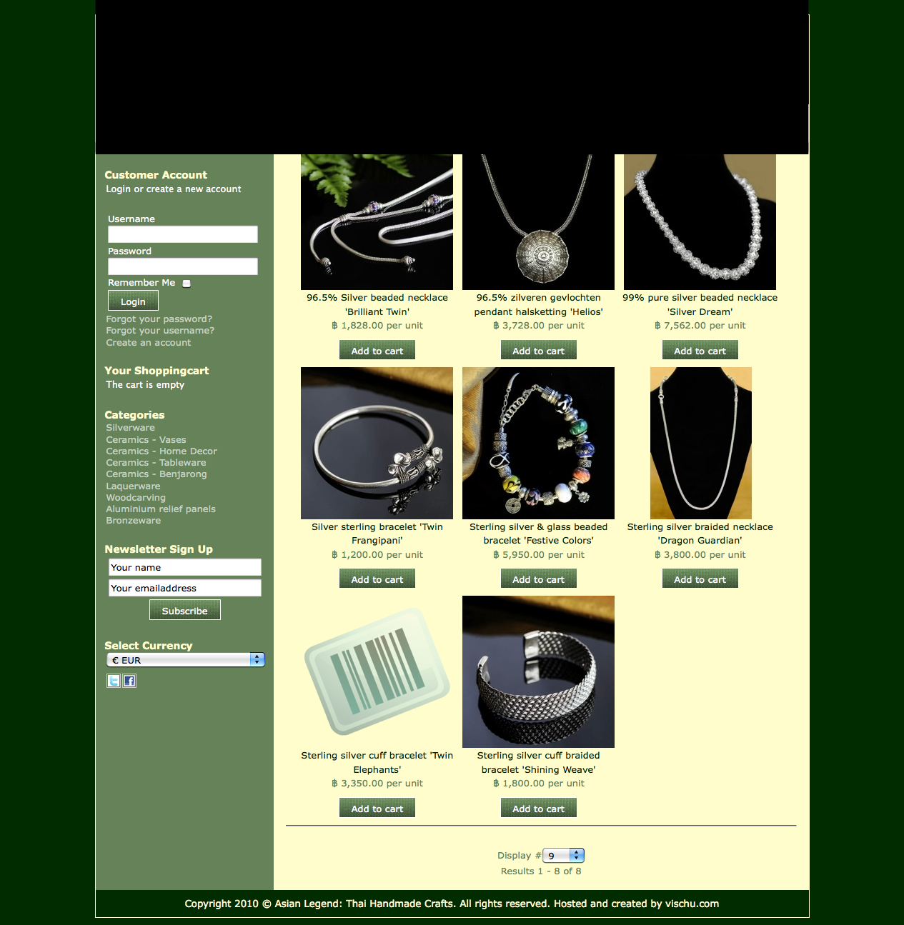

I'm trying to use the business edition auto currency update feature, but cannot get it working the way I have it in mind.
My base currency is Thai Baht. I have defined additional currencies to be Euro and US$. When I enter only Thai Baht prices in my products, on the product detail page it shows my product with the right price in either Euro or Dollars.
However when I show a page with all products in a product category, it shows all prices in Thai Baht, whateven the currency I selected in the currency selector. How can I show the prices there in Euro or Dollars too?

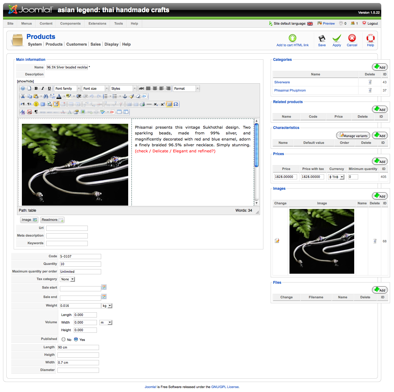

Maybe there is a bug but it's working fine on our end. When we change the currency in the currency selector, the page is refreshed with the prices in the correct currency. Could you give us a link to that page along with a screenshot of the configuration of one of the products displayed ?

Anyway, this is the page that is causing me problems: www.thaihandmadecraft.com/cms/index.php?...re&Itemid=22&lang=en .
Attached are the pictures of the page and the productdefinition for the first product.

Here is the other image:
