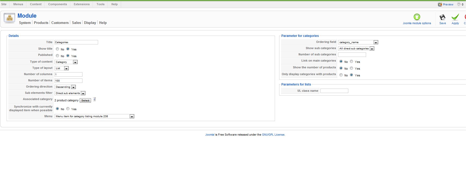

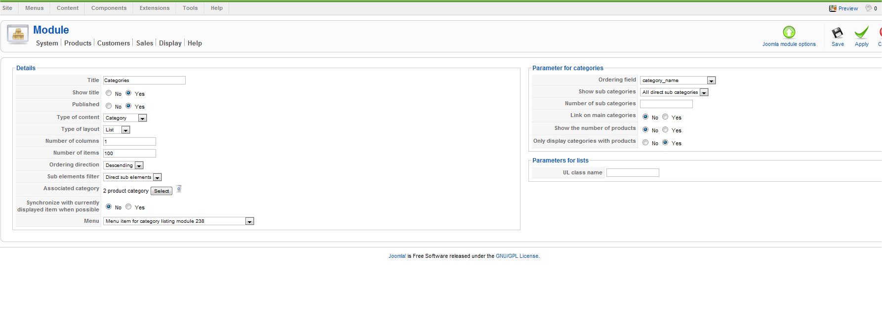

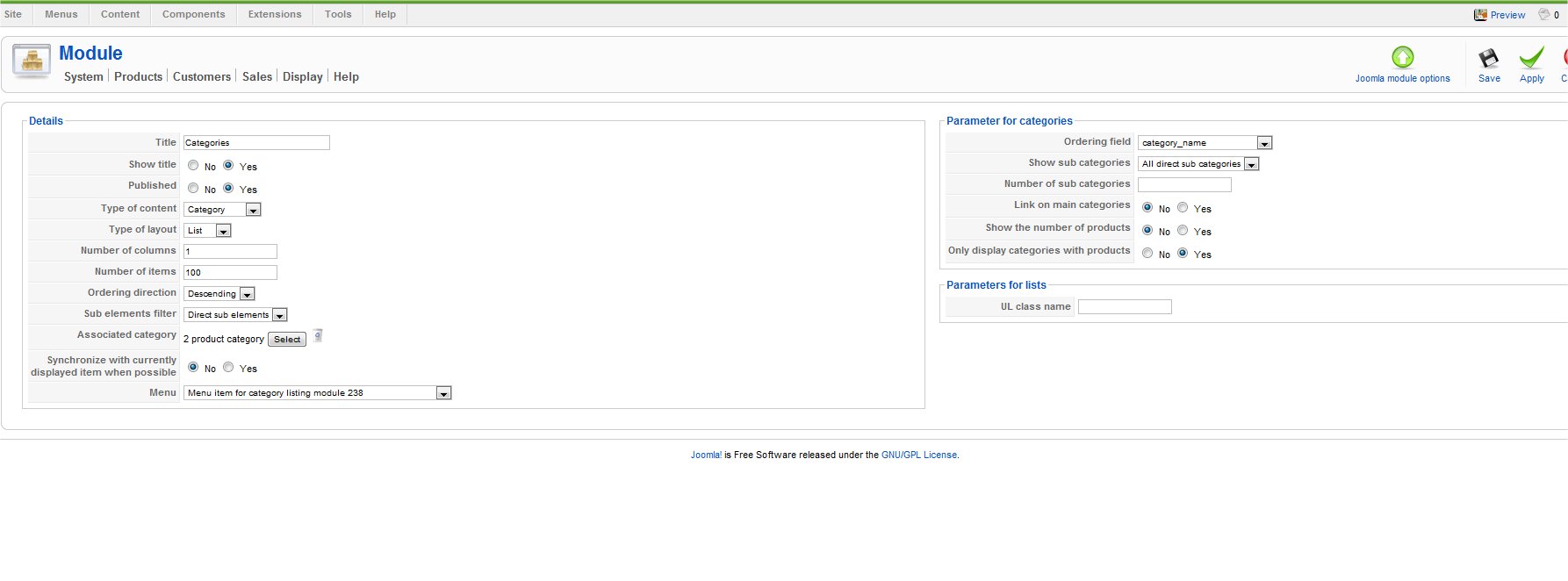

  • Posts: 14
14 years 6 months ago #41753
That's what I thought but it doesn't work
See attached for the settings I have
