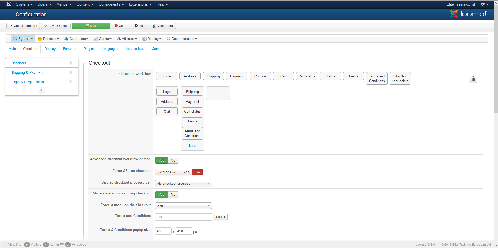

11 years 7 months ago #189247
Thanks for your reply. I thought I had configured in the correct way but it doesn't seem to work? (please see attached)

11 years 7 months ago #189274
In your case, your customers will have to select their address, and then go through the next step to select their shipping method, so can you give me more information about why it's not working ?

I had already posted an image of the settings and they have not changed? Also the shipping is still shown in the cart although no shipping address has been specified. Sorry but I don't see this as fixed?
