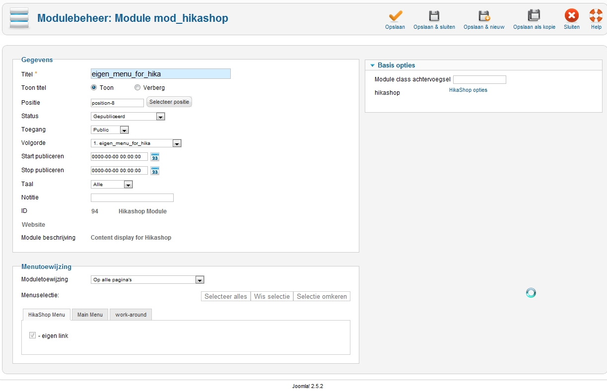

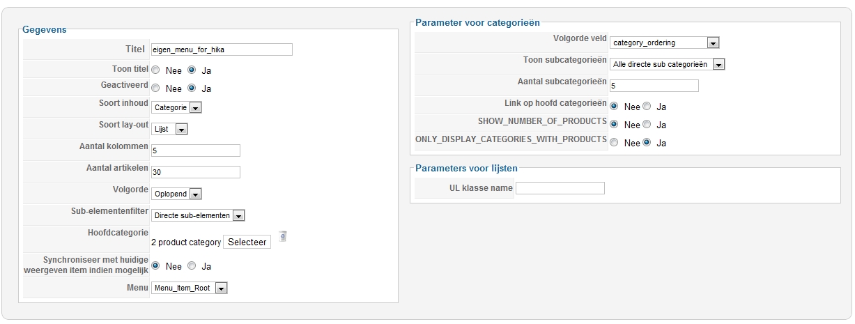

i've included 2 screenshots. The first one is off the joomla options of the module, the second one is the hikashop module options...
As you can see it's set on catogerie and list (lijst).
So is this right, or did you meen somewhere else???
Thanks in advantage
Marc
  • Posts: 86178
  • Thank you received: 14214
14 years 6 months ago #42572
In the hikashop options of your module, I can see that you selected "Menu_Item_Root" in the menu option.
I suppose that this menu is NOT a hikashop category listing menu. Change that and it should work.
