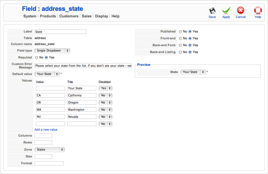

Display->Custom Fields
Table: address; Column name: address_state; Label: State; Field type: Single Dropdown; Required: check; Order: 8; Front-end: check; Back-end Form: check; Back-end Listing: --; Published: check; Core: check; ID: 12
I will also provide a screen shot of the various settings for the state custom field.

  • Posts: 86183
15 years 8 months ago #4210
The problem is the custom field.
The default address state doesn't have the zone codes as value but the zone namekeys. That's why it doesn't work.
You should try to set the type of your custom field to "zone". If you want to remove states from it, you should just unpublish the zones via the menu System->Zones

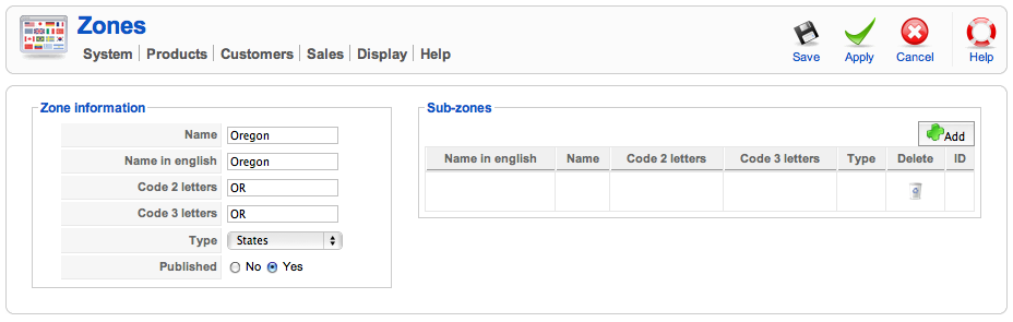

Hm. So now the State field in the front end checkout disappears so the customer can't enter anything. How do I set the Zone information so that the choices appear here? (I deleted all of the bazillion states that came with the HikaShop plugin and added back only the few states to which I can ship. Sorry! I thought I was simplifying, not complicating.)

15 years 8 months ago #4214
Instead of deleting them, you should just have unpublished the ones you didn't need. It can be done with a few clicks.
Instead of trying to fix all that, you could just remove all your zones and reinstall hikashop. That will put back all the zones back.
