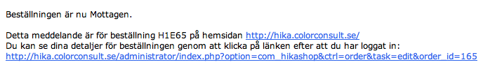

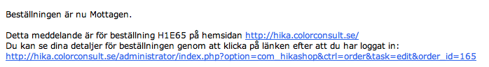

I would like to make a change to the links that are in the head of the emails that are sent out.
I want to change it so that the ordernumber has the link to the order that is written out in full on the third line.
Same thing with the URL to the site, I want that to have the sitename as a link instead.
Where can I change this?
Jan

Ok, thanks for pointing me in that direction. I did take look at it before but now I got it :)
Here is my changed code that gave me the ordernumber as a link to the orderpage, looks better and I suggest you make it like this in a future release.
<?php
          $url = $data->order_number;
          $config =& hikashop_config();
          if($config->get('simplified_registration',0)!=2){
          $order_link = '<a href='.$data->order_url.'>'.$url.'</a>';
          echo JText::sprintf('ORDER_CREATION_SUCCESS_ON_WEBSITE_AT_DATE',$order_link,HIKASHOP_LIVE, hikashop_getDate(time(),'%d %B %Y'), hikashop_getDate(time(),'%H:%M'));?>
