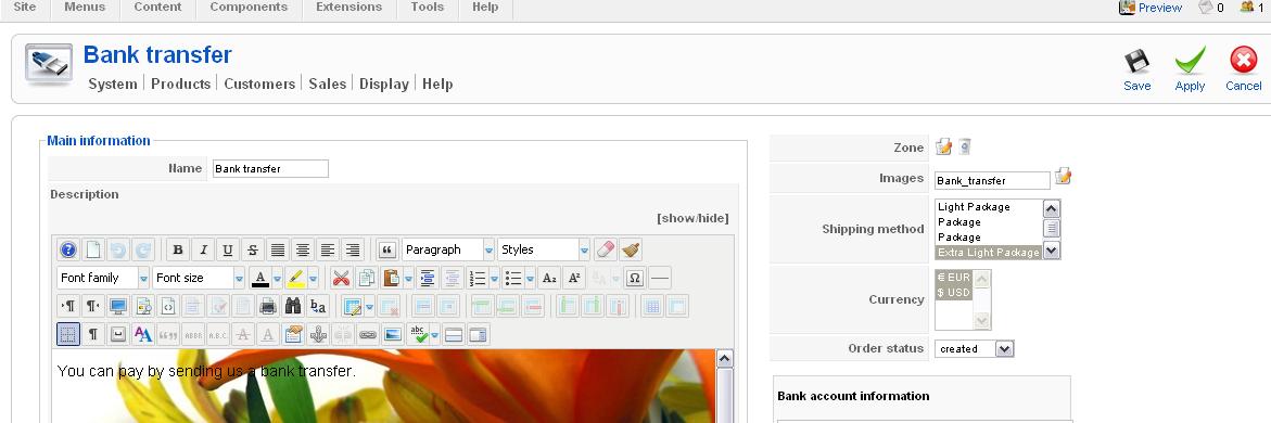

Hi, once again.
I would like to ask how i may display bank transfer for a country. Although bank transfer is not limited to any country it doesn't display for a specific country :(
Nicolas sorry for bothering you so much. I know i've made it so many times and no solution. Checked and doublechecked before post here

So do you mean that it displays for other countries ? Could you do a screenshot of the configuration of that payment method ?
Could you also check all the different points of the FAQ there:
www.hikashop.com/en/support/documentatio...ins-listing.html#faq
If you don't see your payment method on the front end, it must be one of the problems listed there.

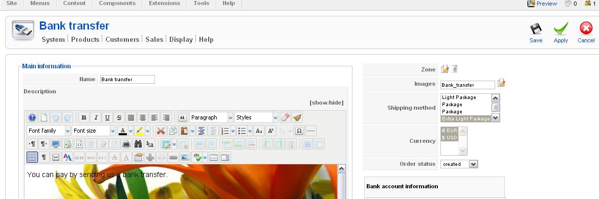

Please unselect the shipping method you selected for it and then it should always display. You can do that by pressing ctrl and clicking on the selection you currently have.
  • Posts: 97
14 years 5 months ago #43679
Thank you, thank you very much Nicolas. A detail that i haven't noticed. You are a god Nicolas. :)
