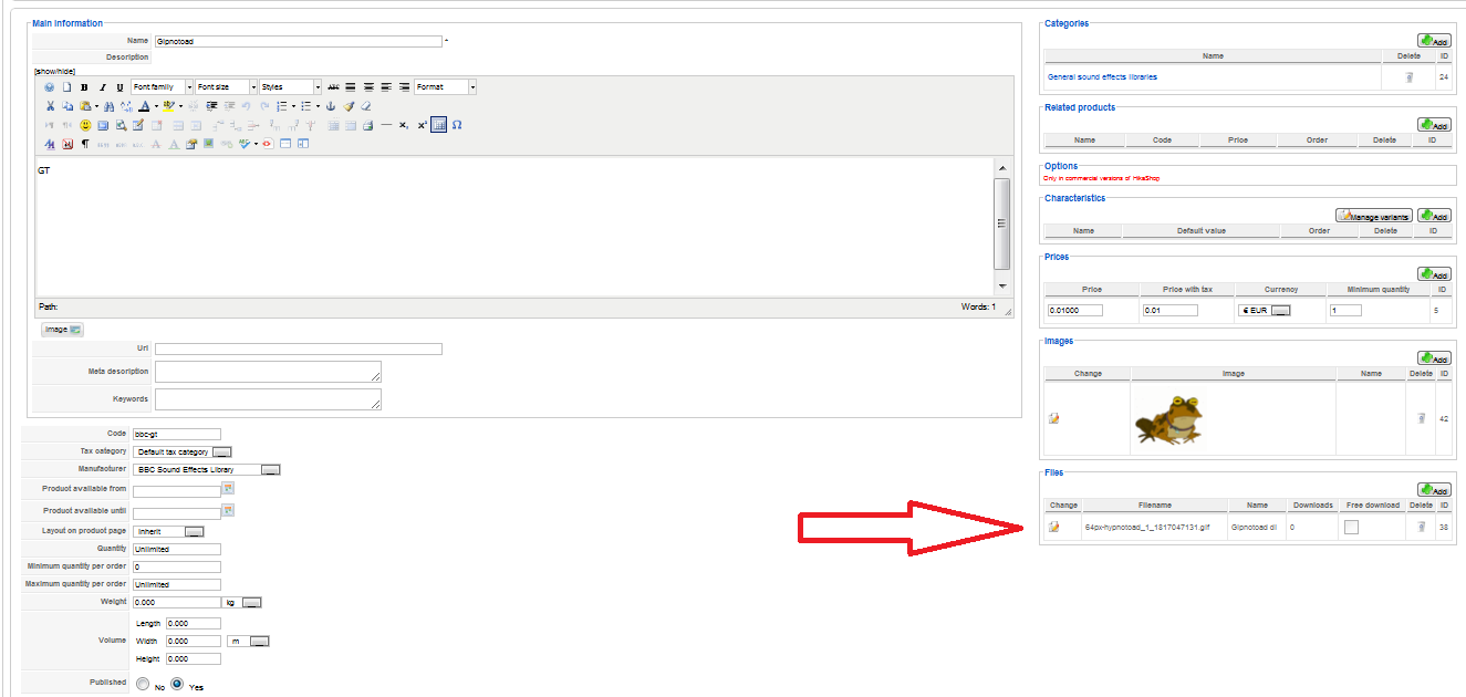

14 years 5 months ago #43796
And do you still have the file attached to the product when you edit the product ?

Yes (see the capture of the test dwnloadable product I use now).
