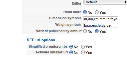

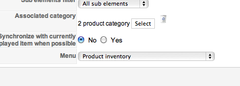

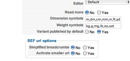

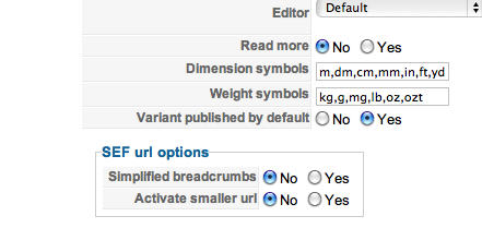

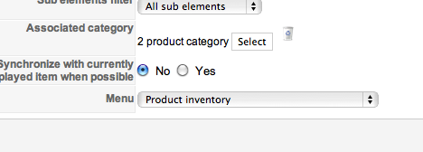

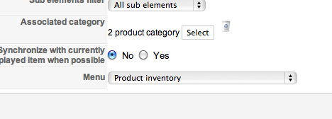

14 years 5 months ago #44110
I've attached images of the settings. One is the SEF settings, the other the Content Modules. As far as I can tell, that should turn SEF off, and the content module does have a menu selected. If it's wrong, can someone show me a screenshot or something of how it should be set?
  • Posts: 86178
  • Thank you received: 14214
14 years 5 months ago #44115
Your screenshots are the configuration of HikaShop.
You need to turn off SEF in the configuration of Joomla:
dezinezone2002.com/wordpress/2009/12/joomla-1-5-sef-urls/
