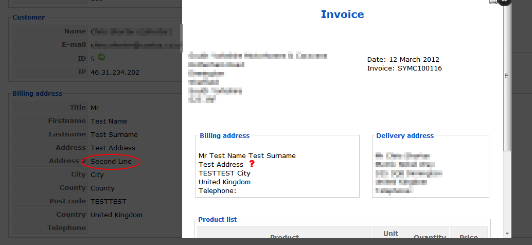

When I click on Invoice or Shipping Invoice on an order, it doesn't show the second line of the address (see attached).
I tried adding it into the address template but it didn't help.
{address_title} {address_firstname} {address_lastname}
{address_street}
{address_street2}
{address_city} {address_state}
{address_post_code}
{address_country}
I also tried restoring the Invoice and Address Template to their original states with the recycle bin icon but it didn't change.
Sometimes, customers put their whole street name in the second box so it's quite important.

That means that you're not editing the view file for the correct template.
Please note that there are several address_template files. The one for the view "address" is for the front end. The one for the view "user" is for the back end. And when you edit them, you need to make sure that you're editing it for the template you're using on the front end or the back end, accordingly.
