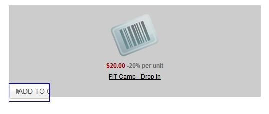

My Add to Cart Button text is too large. I have attached a screenshot. What changes do I need to make to change this.
I tried adding this in the frontend_custom.css through your admin interface.
/* Custom Button Font Size
.hikashop_cart_input_buttons{
font-size: 8px;
The following user(s) said Thank You: Odda

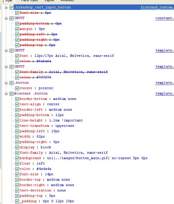

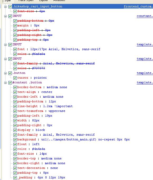

  • Posts: 8
15 years 8 months ago #4418
See attached file for what the CSS is doing
  • Posts: 86183
15 years 8 months ago #4419
That's because your template override the class font size.
Try this instead :
#hikashop_category_information_menu_1 .hikashop_cart_input_button{
font-size: 8px;
by using a parent element's id, there are more chances that this CSS will preveal over your template CSS.

  • Posts: 8
15 years 8 months ago #4421
[SOLVED] I changed the CSS to
font-size: 8px !important;
It seems the !important did it.
Thanks for your help.
As I am just beginning the setup I expect you might see further questions from me.
