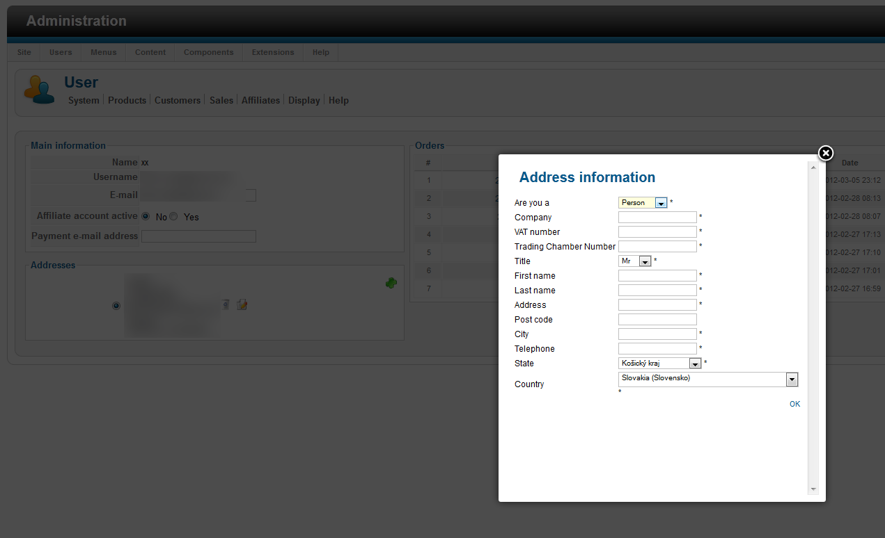

i've just discovered an issue on backend side.
as maybe you remember i created custom fields to make difference between companiesand individuals in order to request additional information for companies.
see my post: http://www.hikashop.com/en/forum/4-how-to/37195-solveddifferent-custom-field-in-address-template.html#37609
Now when i try to add on BACKEND side an address i get form only as COMPANY was automatically selected. Worse, even if i change custom field to "Indivduals" the form is not changing (so hidding not necessary fields like VAT numbers, company name, etc..)
To understand i attached a screenshot to my post

That's normal. On the back end all the fields are displayed so that you have a complete control on the address data. Just enter what you need.

The problem is not that all fields are displayed, it's that they are mandatory as all seems to be "Attached" to "Company" as type of customer :-(

The mandatory check is not done for address fields on the back end. So you should be able to leave the fields empty and still be able to save successfully the addresses.
