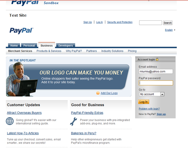

Hi there,
I set up a Sandbox Account, created both buyer and seller account.
Add www.sandbox.paypal.com/cgi-bin/webscr and the sandbox seller email address to the Paypal Plugin,
I log in to the Sandbox Account and back to my website and shop, once I click next button in the check out page this is what I get... I am totally stuck, what do I miss here? It doesn't direct to the normal paypal transaction at all. It keeps going to the sandbox account information page :( Please help.

It's not
http://www.sandbox.paypal.com/cgi-bin/webscr
but
https://www.sandbox.paypal.com/cgi-bin/webscr
that you should use for the sandbox URL in the paypal plugin's option.
The following user(s) said Thank You: shanwell
  • Posts: 31
14 years 5 months ago #44598
Thank you so much..... It works now. I should be extra careful next time :)
