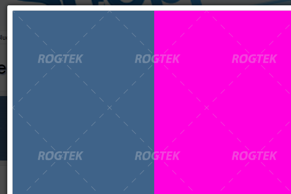

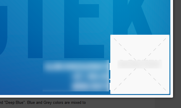

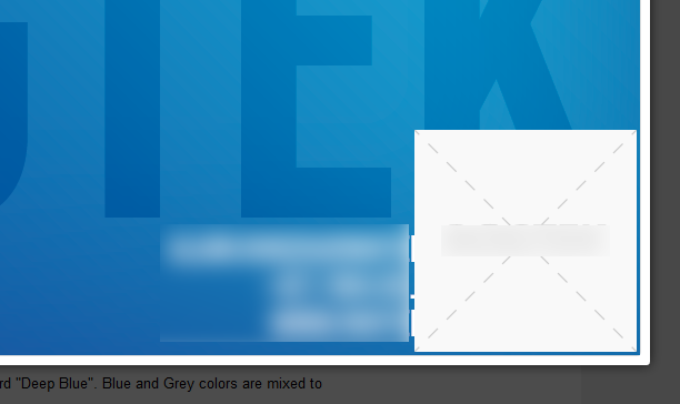

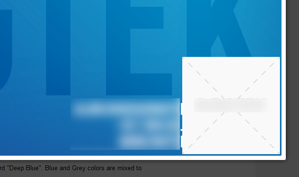

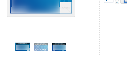

i created a transparent 200px * 200px PNG watermark.
i uploaded it normally in the tab "Confirguration > File" and i upload next product images.
now comes the funny thing...
1. my transparent PNG is not anymore transparent on the product (lightbox) but transparent turned to light grey.
2. a standard watermark is repeated vertically and horizontally over the WHOLE picture, however in hikashop it is only display once... :-( as it is merge with original image during uploading, it is not possible to fix it with css (repeating at least).
3. a certain margin appears among borders of product image and the waterman. This should not be as the waterman should overlay the complete product image without margin.
4. Opacity even if i setup it at 50%, everything stays at 100% normal without transparency.
see the attached screenshot.
so what did i do wrong ?
thx.

14 years 5 months ago #44518
Hi alain.roger,
I think your problem is due to the image format.
Did you try with a different bit ratio ?
8bits maybe ?
Watermarks are for the moment not repeated horizontally or vertically, the best solution is to place it diagonally.
The margin is maybe an override made by your template.css file.
I think the opacity don't change because of the non-transparency of the picture.
  • Posts: 192
14 years 5 months ago #44564
Hi Xavier,
based on you information, i created a PNG and a GIF in 8bit but i still have the same issue. margin on the bottom right side betweem watermark and product image and the watermark is not transparent but light grey :-(
i attached to this post a watermak example. as you can see the transparent background is really transparent.
so the problem is not in 8bit or 24 bits... neither in the format PNG or GIF... :-(
moreover how could my CSS create a bottom right margin for merging as the product image in light box has no css :-(
What does not kill you, makes you stronger.
  • Posts: 86178
  • Thank you received: 14213
14 years 5 months ago #44797
We tested that and we were able to reproduce the problem with your image. The problem seems to come from the transparent color used in the watermark image.
We've changed some stuff in the code which handles the watermark and it's now working on our end with your watermark.
Please replace the file administrator/components/com_hikashop/helper/image.php by the one in the archive enclosed and it should work for you too.

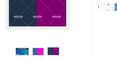

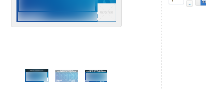

so I've tested your updated version of image.php file.

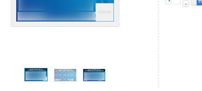

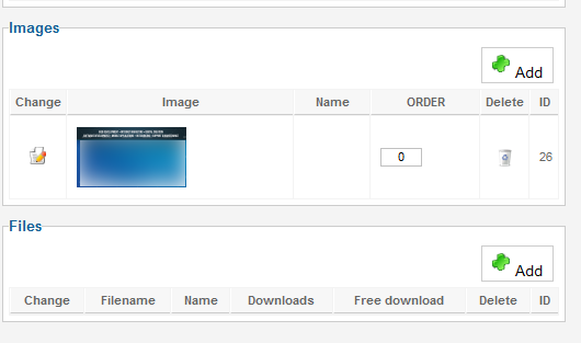

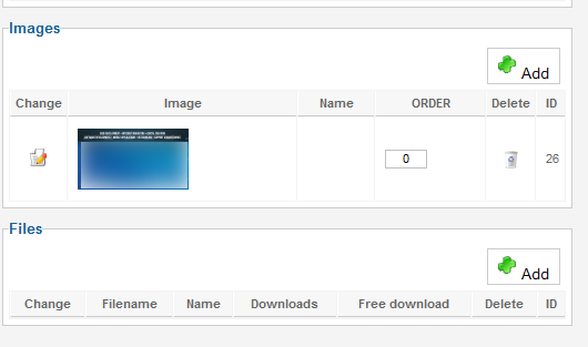

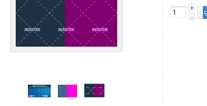

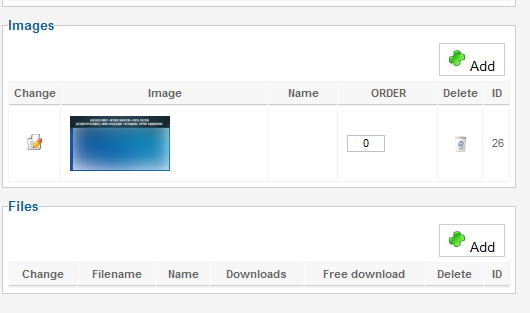

Bugs
1. everytime i remove a product image and add a new image, in the front end, a new image is added to product detail form > thumbnail.
this is a bug as for example i have a product with only 1 product image and not in the front end, user can see 3 images :-(
product images on backend
frontend : what customer sees
or another product:
i tried to clear cache and purge old cache, but it didn't help... i tried in another browser that i never use for development and even if in this browser, i have multiple product images as thumbnails.

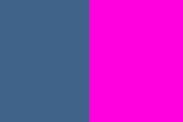

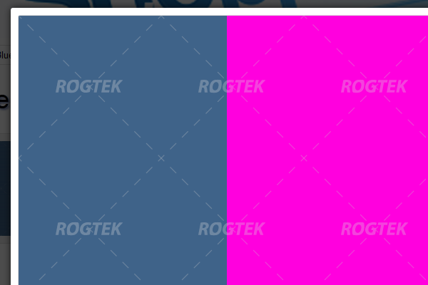

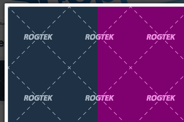

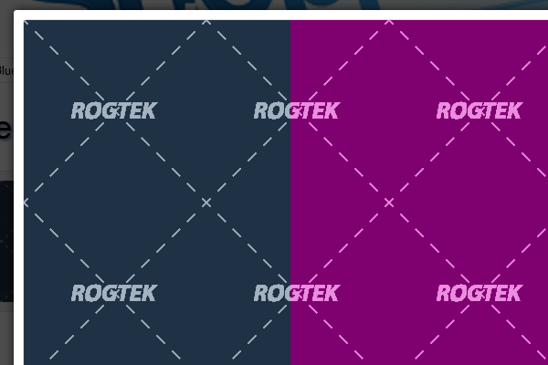

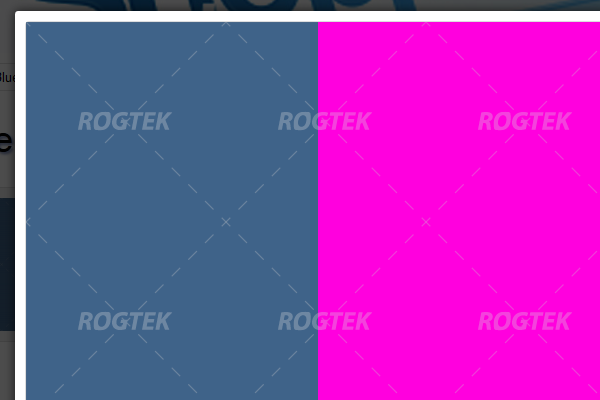

2. when i set transparency to 50%, the whole image (product image + watermark) are set to 50% transparency, so everything looks like light grey image..I don't know if we can tell it's a transparency are only watermark should have it's transparency changed and not the whole image. The whole image or only the watermark should not be "greyer" if transparency is something else than 100%, but it should be MORE transparent... at least this is for me what means transparency. (see difference between "original image" and "image 1".
Moreover i did the following test:
step 1: i set transparency to 50% and uploaded an image (image 1),
step 2: i set transparency to 100% and uploaded an image (image 2),
step 3: i set transparency to 50% and uploaded an image (image 3)
in theory, images 1 and 3 should look like the same...however in real life (and this is weird) image 3 is darker than image 1 even if image 1 and 3 have the same product image, the same transparency level and the same size :-(
original image:
image 1:
image 3:
3. when i upload my watermark, image quality is depreciated and it is no more such sharp and nice as it is before uploading.
before company logo was sharp, nice, readable, after upload into hikashop.... it is only somehow readable..
it is needed to keep the same quality in rendering product image with pasted watermark as both have before merging.

14 years 5 months ago #44843
1. We don't have that problem on our end. Are you saving your product after deleting the images ? Otherwise it won't do anything.

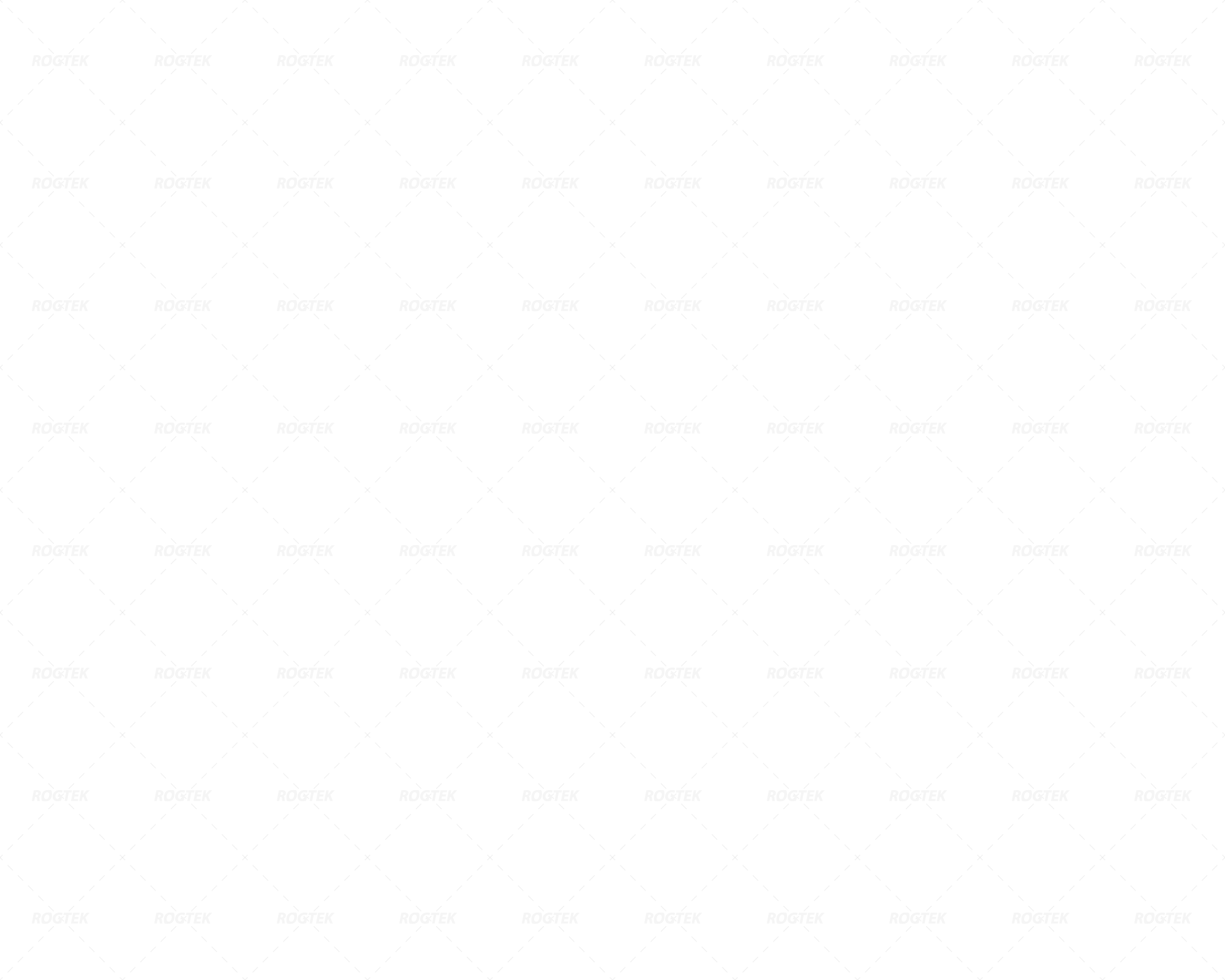

  • Posts: 192

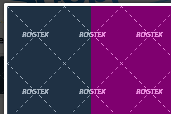

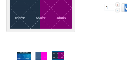

14 years 5 months ago #44968
Nicolas,
i've just tested your new version of image.php and here are the results:
1. If transparency is not set to 100%, the watermark is not applied or not visible at all.
2. whatever is the watermark (8 or 24 bits, Gif, PNG or something else) all colors except transparent one, are FULLY colored so if you have a light grey (as i use), once watermark applied, light grey will appears WHITE :-(
i don't know for you but for my point of view, it's worse as i was few days ago.
Any idea ?
thx.
