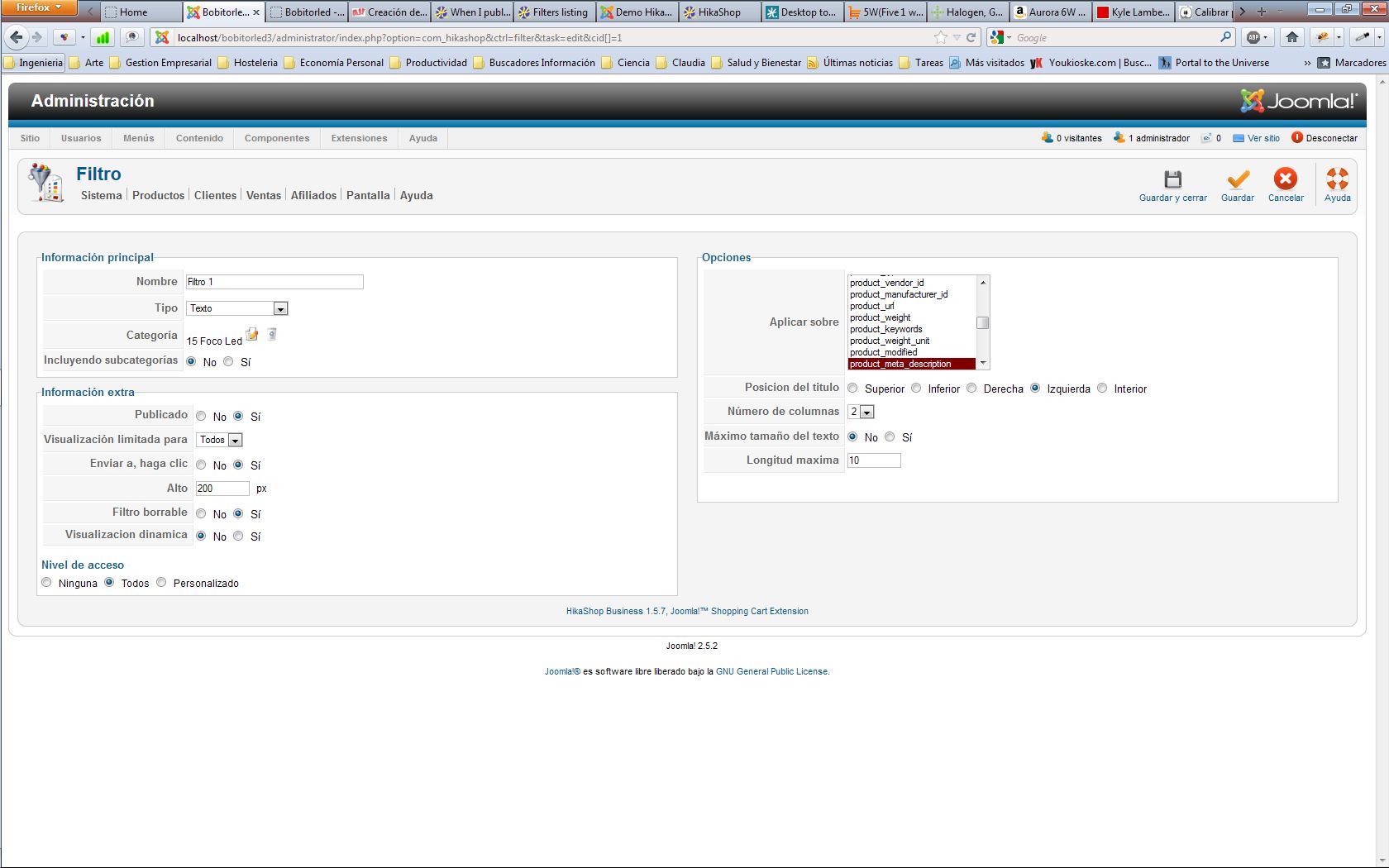

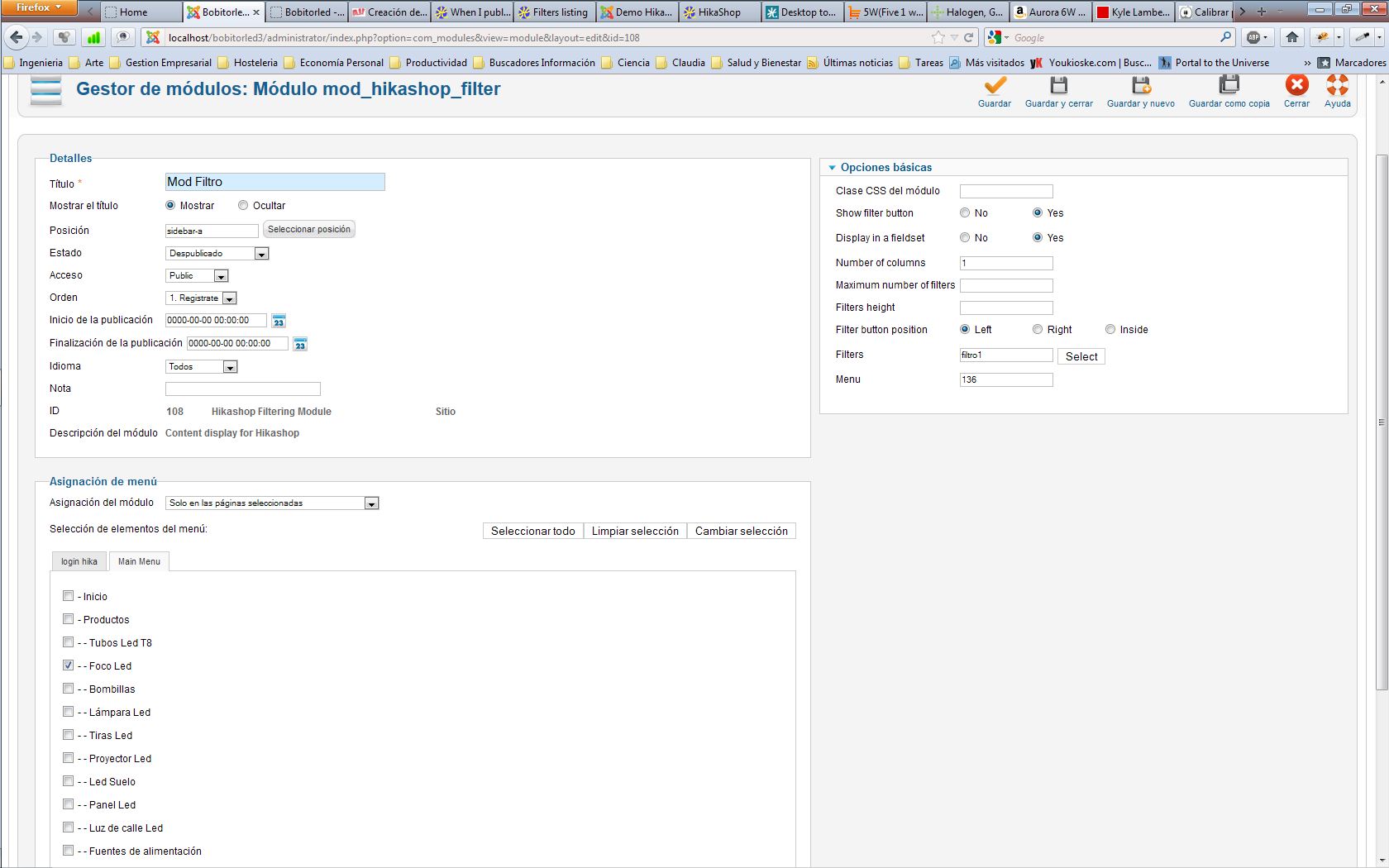

Yes but we need more information in order to help you. Could you do a screenshot of the options of the filter and also give us the error message that you have in your PHP error log for that blank page ?
  • Posts: 32
14 years 5 months ago #44599
Here you are the files you requested me.
Thanks,
  • Posts: 86178
  • Thank you received: 14214
14 years 5 months ago #44766
Please edit the file administrator\components\com_hikashop\classes\filter.php and remove the code:
$html.= $thiscart->displayButton(JText::_('GO'),'filter',$this->params,'#','return false;','id="hikashop_filter_direct_button_'.$filter->filter_namekey);
That will solve the problem.
