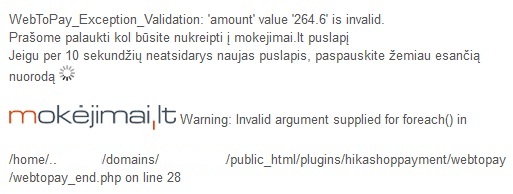

13 years 9 months ago #71438
nicolas wrote: If we don't have the precise error it won't be possible to help you. If you want us to help you, we would need to know that at least.
Nicolas, here is the error (the real amount shown in frontpage is 2,65):
here is the code, that error is pointing at:

  • Posts: 86053
  • Thank you received: 14181
13 years 9 months ago #71523
It means that $request doesn't exist.
That should be defined in the webtopay.php file. As you didn't provide it I can't see why that happens. Could you attach that file too ?

  • Posts: 86053
13 years 9 months ago #71731
The problem comes from that line of code:
'amount' => 100*$order->order_full_price,
in the file webtopay.php
It should actually be:
'amount' => (int)100*$order->order_full_price,
