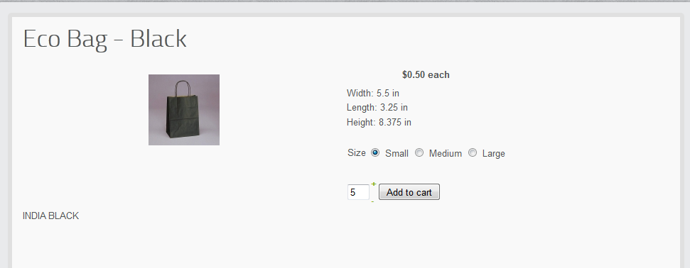

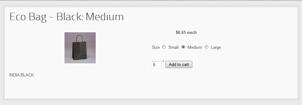

I have created products with three variants - small medium and large. each variant has its own price and dimensions.
The problem I have is the product displsy shows the dimensions of the default variant, but does not display once I click on another variant.
See attached - file 1 is the forst disp with def product variant.
file 2 shows what happens when I choose a diff variant.
Help pls...

Indeed, that's a bug in the current release. Please change the code:
		$this->setLayout('show_block_dimensions');
		echo $this->loadTemplate();
	</span><br />
to the code:
	</span>
	<?php
	?><br />
in the file "show_default" of the view "product" via the menu Display->Views and it will fix the problem.
