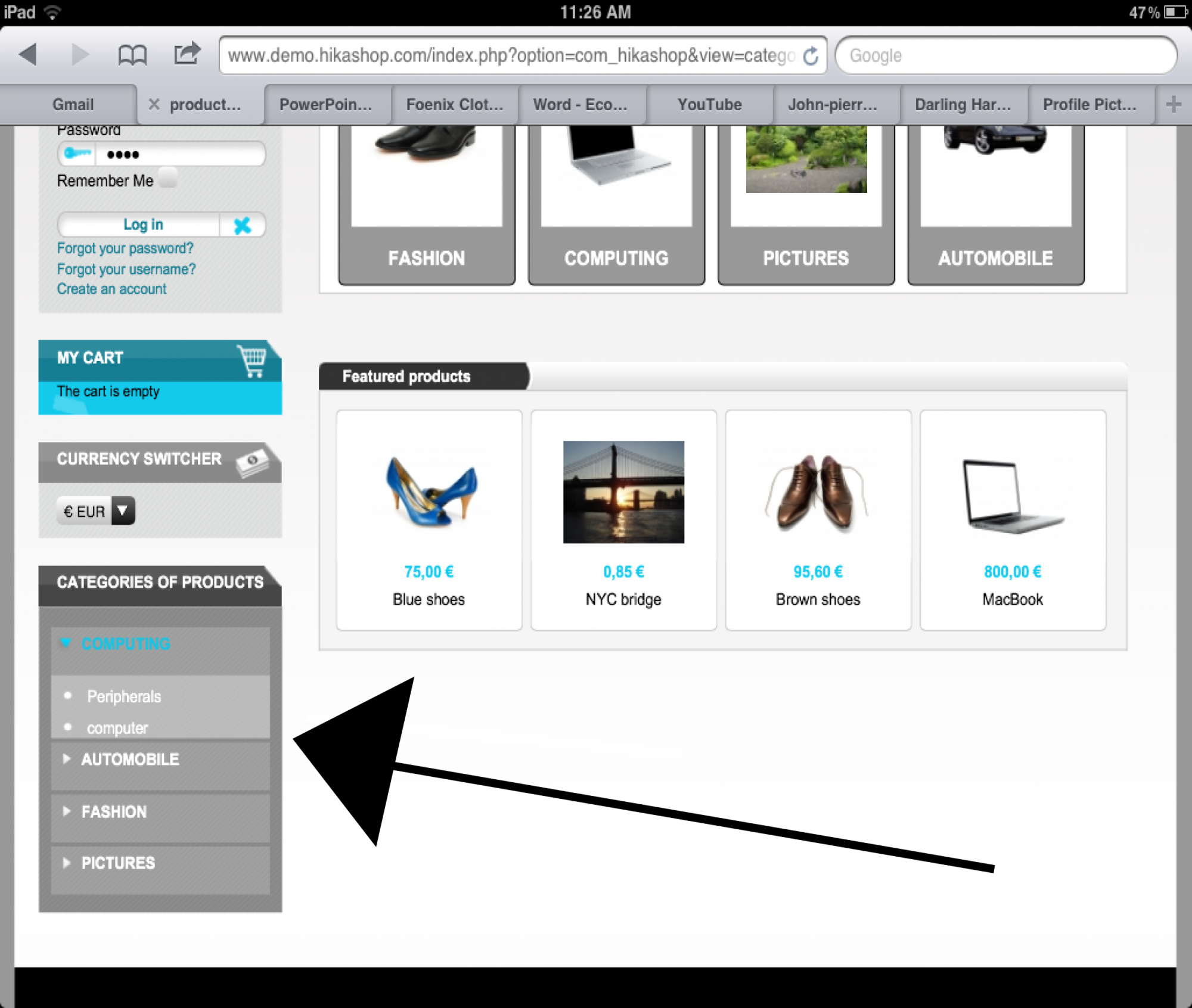

Hey i have an online store but as the products started to increase i have decided to add catogories. Now how do i add that table shown in the pick. I saw it on the demo and would like to add to my website

Hi, Thank you for your support and replies. regarding this question please point out how to create the effect similar to demo whereby the category opens a subcategory whenever you click on an item in the "CATEGORIES OF PRODUCTS" list.
I followed the tutorial however the subcategories open in the product display area?

Please check that the options of your module are the same than the options of the module on our demo website:
www.demo.hikashop.com/administrator/inde...odules&task=edit&cid []=120

I copied the options as in the demo site however the sub-categories are not showing with same effect as in demo site. Instead the are always showing with smaller font size under their main categoies.

The option "Show sub categories" of your module was not the same as on our demo website:
merc2.cloudaccess.net/administrator/inde...odules&task=edit&cid []=95
it was set to "all sub categories" instead of "all direct sub categories".

please bear with me, why does my sub categories appear in one line and not each on a separate line.

You can do like that in order to avoid that:
www.hikashop.com/forum/4-how-to/41721-ca...y.html?lang=fr#42023
