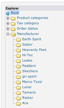

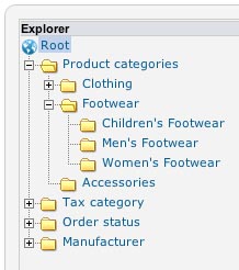

The current categories that have been set up are:
and
Can the requirement be achieved using the categories that already exist?

I have set up a new category 'Footwear by:' and added a child category for each manufacturer, each with sub categories for Children's, Men's and Women's. Products have been placed in the appropriate categories. The module has been set up and is displaying the correct categories and items.

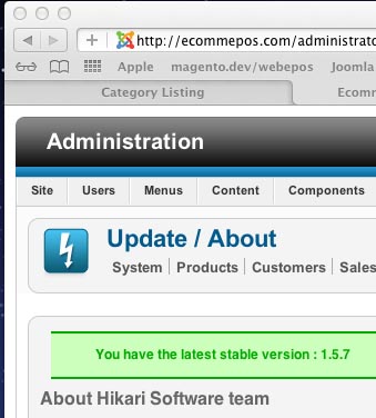

Thanks for the suggestion. The version on ecommepos.com was downloaded last night, but having checked this morning there is now a later version.
I have updated to the latest release, but the issue is still there.
