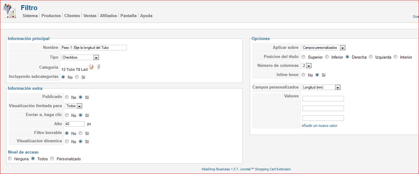

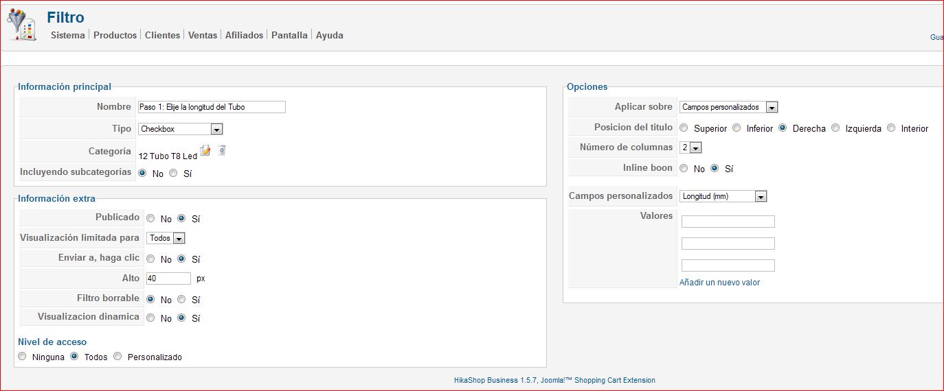

Hi Nicolas, as you can see in the picture below I created a filter type checkbox. I chose Submit on click then I don´t want that the sumit button will be showed. The problem is that in the filter edit page there is not an option to choose Show filter button or not as the help file say:
I tried to no display the buttom writing on css file: #hikashop_category_information_menu_121 .hikashop_filter_button_outside{display:none;}

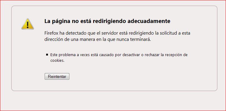

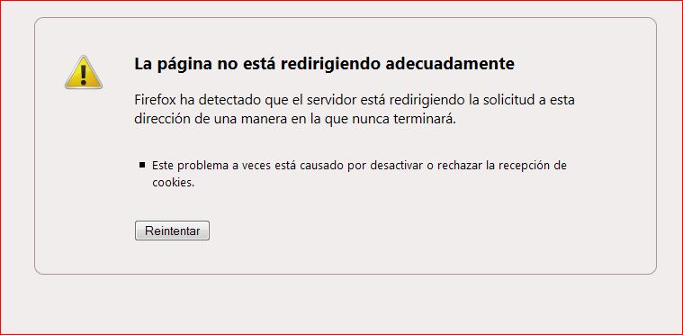

When I have the filters published and I add to the cart some product I am redireted to a wrong page:
When I was in English Languaje the redirect page is:
http://localhost/bobitorled3/index.php/en/productos/tubos-led-t8/product/%86%DBi%FF%F9hq%A9a%A2%CB%7Fn%86%E2%B6%8A%E5y%DD%FF%8Aw%5E%C6%98i%FD%E9%FF%A6%BA%1D%B9%CBh%B3%FBnn%8B%y%DB%7C
An bad request message appear: Your browser sent a request that this server could not understand.
When I was in Spanish Languaje the redirect page is:
http://localhost/bobitorled3/index.php/es/index.php/es/index.php/es/index.php/es/index.php/es/index.php/es/index.php/es/index.php/es/index.php/es/index.php/es/index.php
/es/index.php/es/index.php/es/index.php/es/index.php/es/index.php/es/index.php/es/index.php/es/index.php/es/index.php/es/productos/tubos-led-t8/product/%86%DBi%FF%F9hq%A9a%A2%CB%7Fn%86%E2%B6%8A%E5y%DD%FF%8Aw%5E%C6%98i%FD%EB?%A6%BA%1D%B9%CBh%B3%FBnn%8B%y%DB%7C
and an error is displayed:
Many Thanks,

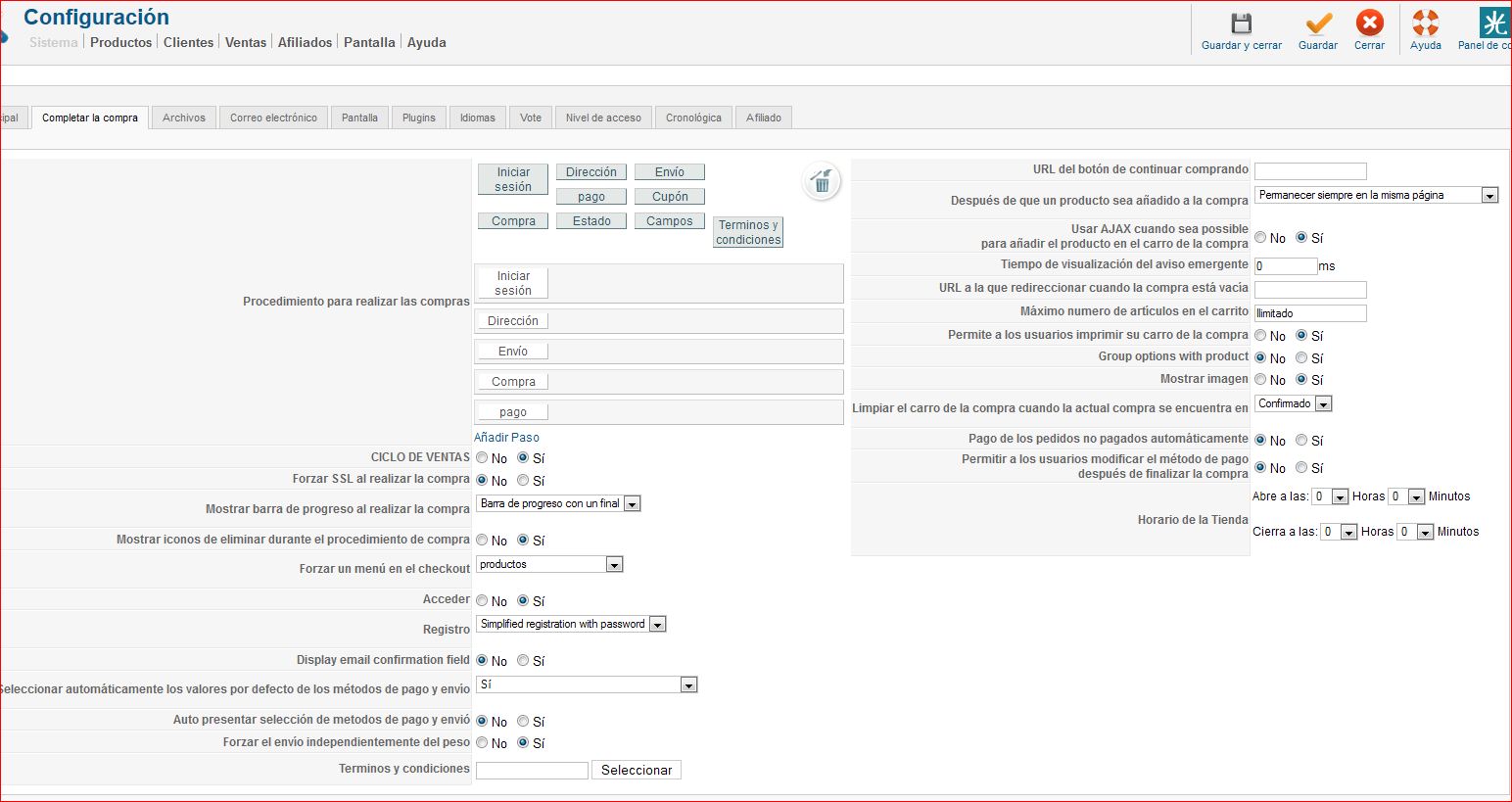

The problem must come from the way the checkout is configured.
Could you do a screenshot of the checkout tab of your configuration so that we can see what you did ?
  • Posts: 32
14 years 5 months ago #46215
Hi, Here you are the screenshot of the checkout.
Many Thanks,

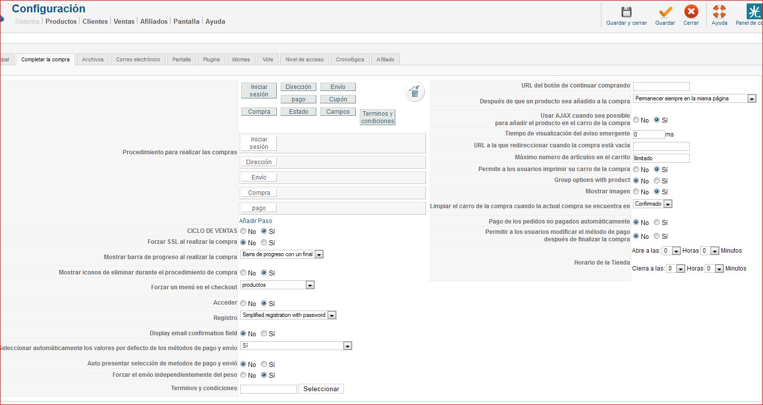

  • Posts: 86177
  • Thank you received: 14212
14 years 5 months ago #46308
Could you try to change the option "After a product is added to the cart" to something else ?
Also, could you try to change the option "Force a menu on checkout" to a hikashop checkout type menu.
  • Posts: 32
14 years 5 months ago #46337
Hi, I changed the option "After a product is added to the cart" to display a notification popup to the user and it works OK. It was not necesary to change the option "Force a menu on checkout".
