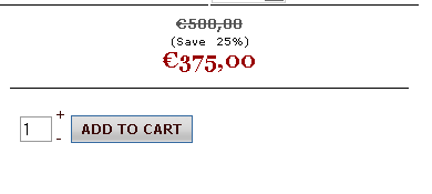

14 years 4 months ago #46769
After a lot of struggle in "listing_price" file, I managed to make the price display as shown in the attachement.
1. €500,00 (Initial Price)
2. -25% (Discount Percentage)
3. €375,00 (Final Price)
There is one last thing though that I would like to be displayed and I've tried everything with no luck.
Which code do I have to add/modify so that the Discount Amount (i.e €125,00) is also displayed?
Your advice would be very helpful!
Thank you.

  • Posts: 86106
  • Thank you received: 14207
14 years 4 months ago #46790
You can use that line:
echo $this->currencyHelper->format(-1*$this->row->discount->discount_flat_amount,$price->price_currency_id);

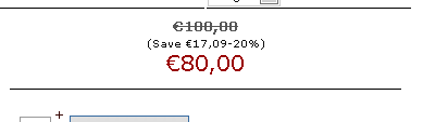

  • Posts: 42
14 years 4 months ago #47053
Almost there Nicolas. The problem now is that the Discount Amount (100,00-80,00 see attachement) is displayed without the VAT (17,09 instead of 20,00). VAT is 17%.
One of my attempts was to add the line
echo $this->currencyHelper->format($price->price_value_without_discount_with_tax-$price->price_value,$price->price_currency_id);
but again the discount amount is wrong. I also have enabled the option my discounts to be applied After Taxes.
I've been busting my head to solve this but unfortunately I need your help again.

  • Posts: 86106
14 years 4 months ago #47313
Try with that:
echo $this->currencyHelper->format($price->price_value_without_discount_with_tax-$price->price_value_with_tax,$price->price_currency_id);
  • Posts: 42
14 years 4 months ago #47323
Thank you very much! That solved the problem..

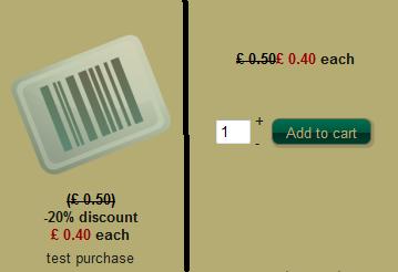

  • Posts: 28
14 years 2 months ago #54047
following on from this post I've done a very similar thing (thanks for directing me here nicolas)
The product listing works fine where the product is viewed in a product listing with other, but when you click to go to the main product page I can't find the code to alter that as well
The result is that the product listing looks like the first picture and the product page looks like the second
Am I being a bit thick because I can't find which code to alter!
Last edit: 14 years 2 months ago by bendraper.
  • Posts: 86106
14 years 2 months ago #54122
It's the same code actually.
However, the options for the product page are in the "Display" tab of the configuration while the options of the products listing are in the menu/module's hikashop options.
So you should look in your configuration for the product prices options so that you have the same values as for your listing.
  • Posts: 28
14 years 2 months ago #54928
right as always, thanks for the help it's looking much better now

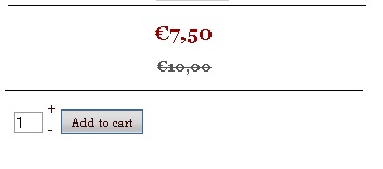

  • Posts: 3
13 years 9 months ago #76814
I would like the same layout displayed when a discount is applied.
I've tried editing the code myself but keep getting the incorrect result. The result like the result you have where the Sale price is shown along with the old price and the saving amount.
Any chance sombody would be nice enough to show me the code to put into product / listing_price.php?
using Hika 2.0
thanks!
13 years 9 months ago #76919
Try to replace your file content by the content of the following file:
  • Posts: 3
13 years 9 months ago #76947
Xavier wrote: Hi,
Hi Xavier, thank you for your reply.
although this had no effect on my layout.
site: www.dp2u.ivisioneers.com
13 years 9 months ago #77046
I think that you have replaced the content of the file in the wrong template.
Time to create page: 0.123 seconds
