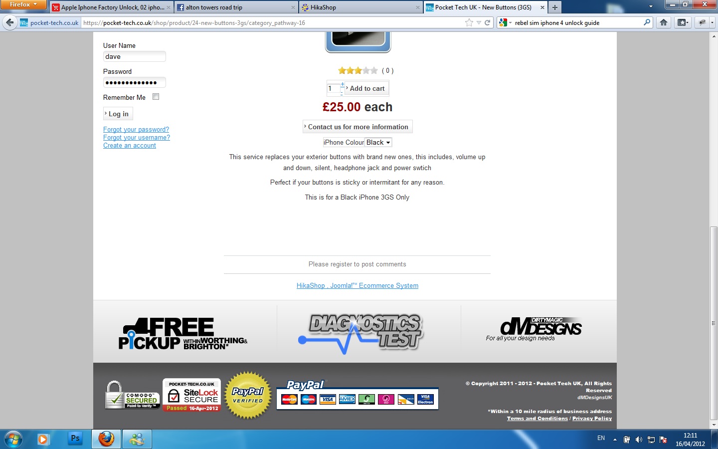

here is a screen shot of the footer displaying. the option for footer is turned OFF in the menu therefore unsure why it keeps displaying for us but not for you.

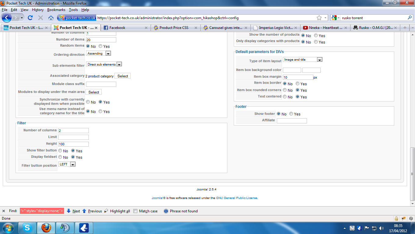

The "show footer" option is not in the menu but in the "Display" tab of the configuration.
You must be changing the wrong setting.

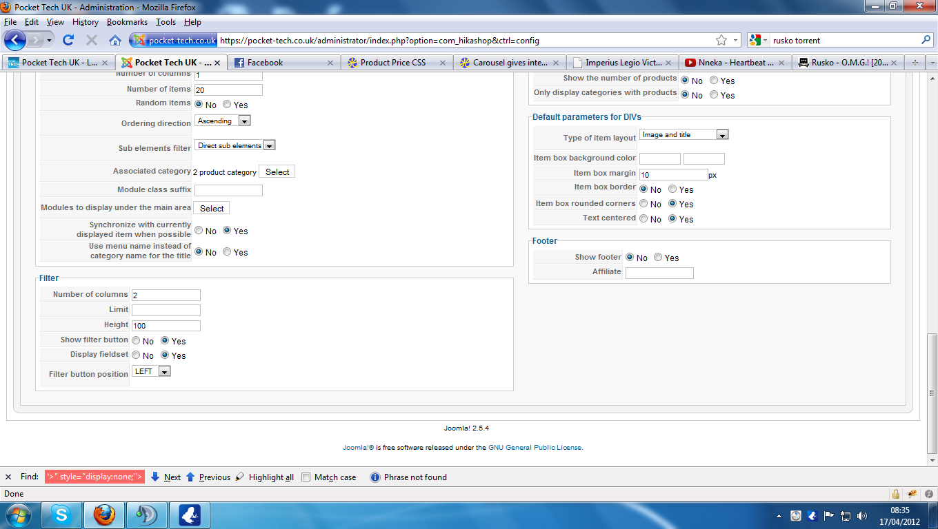

  • Posts: 33
14 years 4 months ago #47148
nicolas wrote: The "show footer" option is not in the menu but in the "Display" tab of the configuration.
Regarding the currency problem, please change the "main currency" option of the configuration to GBP.

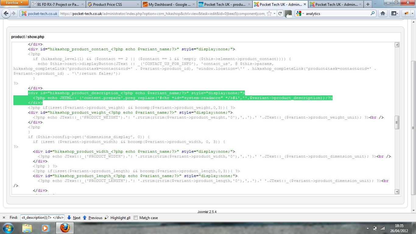

You should try to delete the code below in the file "show" of the view "product":
<div id="hikashop_product_description_<?php echo $variant_name;?>" style="display:none;">
<?php echo JHTML::_('content.prepare',preg_replace('#<hr *id="system-readmore" */>#i','',$variant->product_description));?>
</div>
here is an image of the setting we have turned to off for the footer, is this the right one? if so the footer is still displaying
the only option we have in the main currency config drop down is GBP, we have noticed that it only displays as euros when you are viewing a product, if you are in a catergory or anything else it displays correctly as GBP
i removed that code below and the description still disapears when changing characteristics

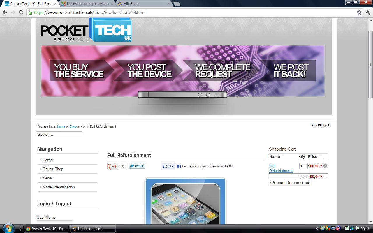

with regards to the shopping cart displaying the wrong currency i did a bit of experimenting myself.
i have endabled the mini cart, which works fine on category pages but when viewing the product iteslf it displays the full cart
any details i edit for the shopping cart module can only be viewed in categorys the "default" is show in the product view

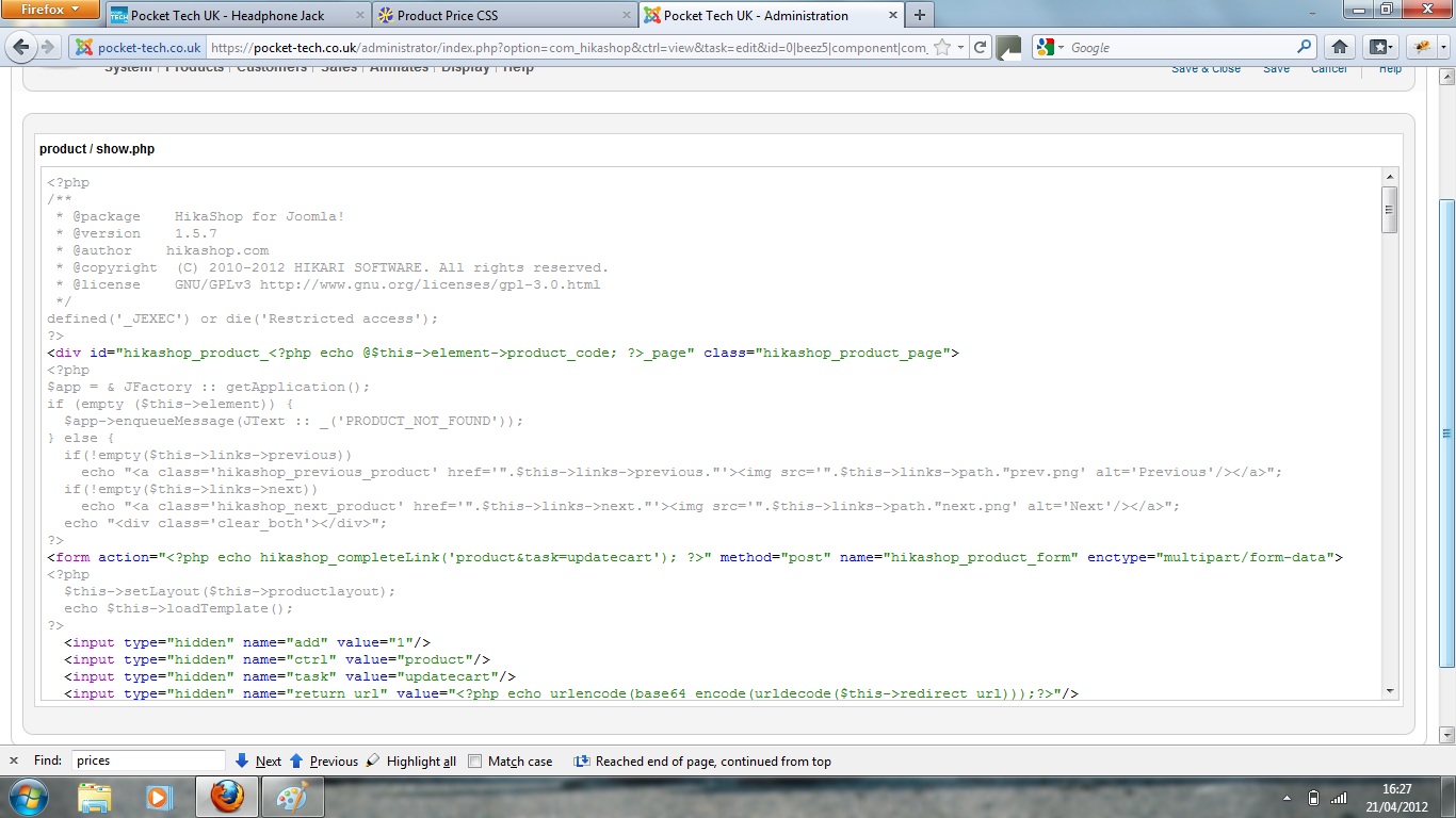

For the cache, also turn off the cache option of the configuration of joomla and potentially the cache option of your template and it should hopefully display properly.

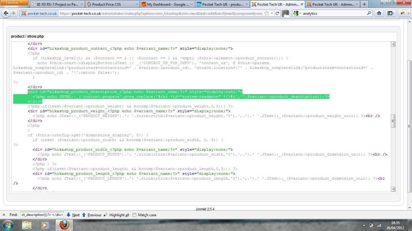

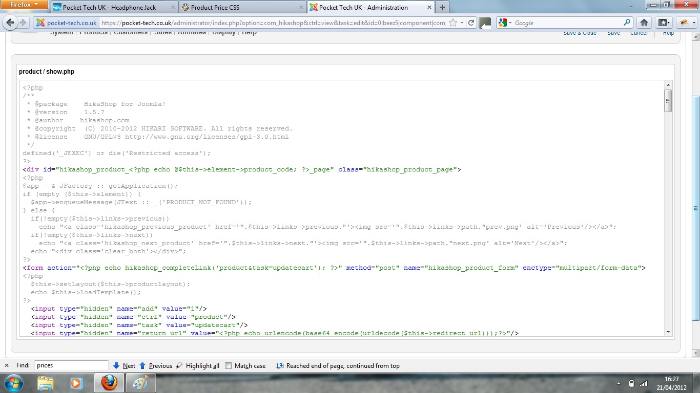

Can you do a screenshot of where you edited the view file ?

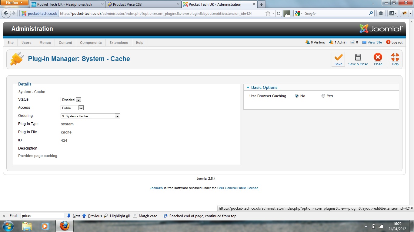

  • Posts: 33
14 years 4 months ago #47746
nicolas wrote: In the hikashop options of your module, you should change the display method for prices so that it does not display them all.
Can you do a screenshot of where you edited the view file ?[/quote

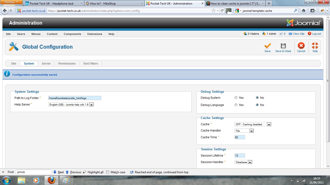

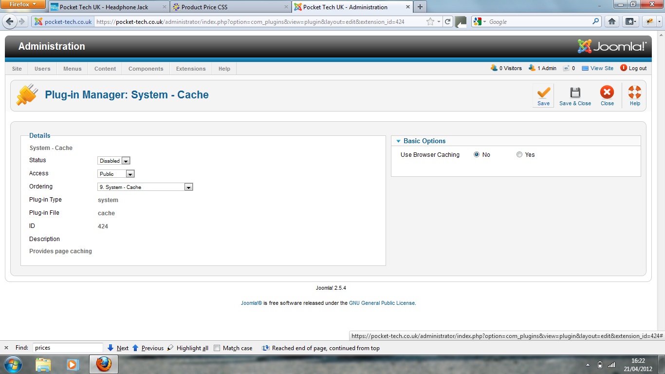

i have turned of the cache in the joomla cache plugin, could you tell me where the template cache is? i have disabled cache in site-> global config -> system

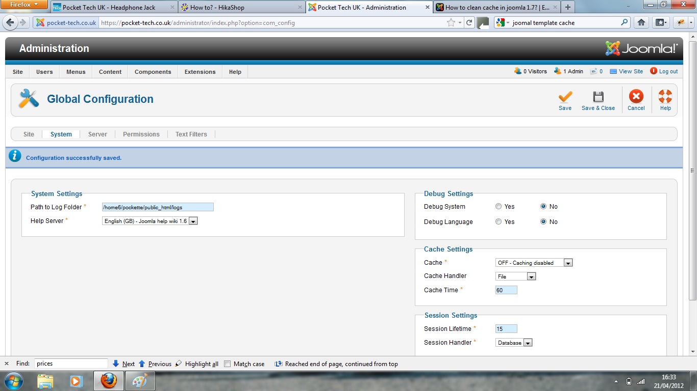

here is a copy of my joomla cache settings
and below is a copy of where i am editing the view file
here is a copy of the global config settings of my cache

Not all the templates have a cache option, but if they have one, it is accessible via the templates manager of Joomla, when you edit the options of the template.
For the screenshot of the product/show.php edition page, I wanted you to show the piece of the code around where you did the modification, not the beginning of the file.
  • Posts: 33
14 years 4 months ago #48331
nicolas wrote: Not all the templates have a cache option, but if they have one, it is accessible via the templates manager of Joomla, when you edit the options of the template.
highlighted above is the code i have removed in the file you suggested

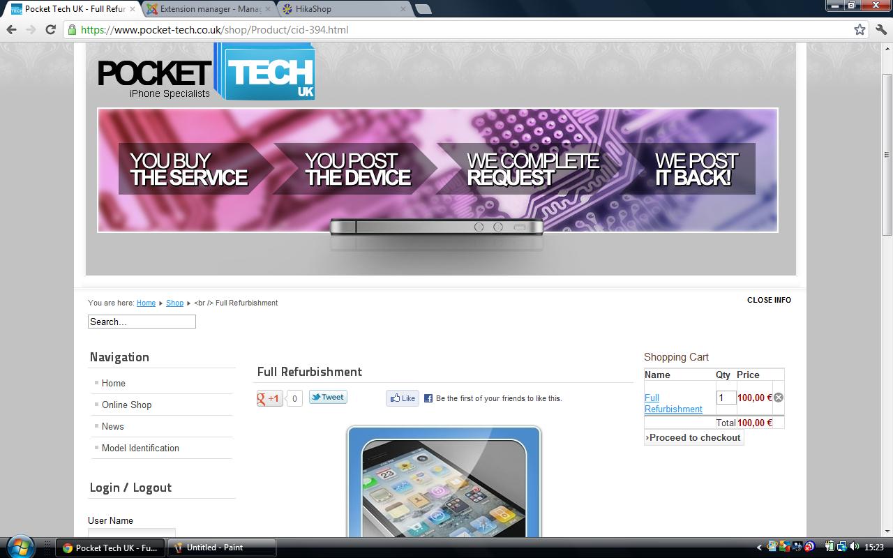

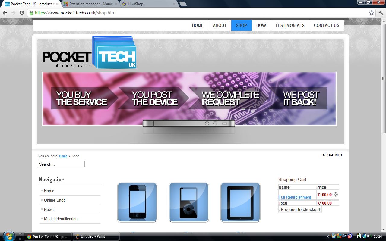

we have not edited anything relating to the cart and the CSS optimiser we had running has been turned of / deleted for a long time now.

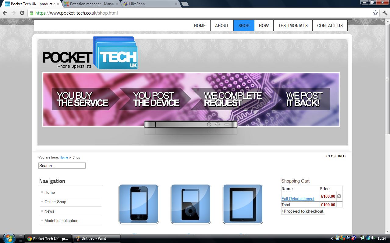

The error only occurs on the product page, not when viewing categories. ( attached images below ) no matter what settings we change, the will not be shown in the products view. it will change on the categories pages and every other pages apart for the product page. as you can see on the product page, there is quantity field which is not visible on the category pages.
would really appreciate if you could log in the back end and have a look for me as we would like to start using the website and this is holding us back :( username and password have not changed since the last time you logged in
