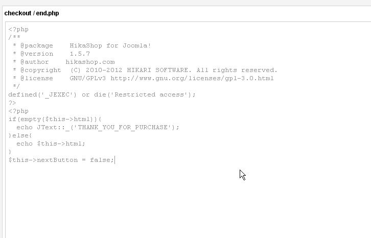

  • Posts: 48
14 years 4 months ago #47291
i suppose i have to insert above code.
But where in that file, i suppose it is this file, see attachment.
Guido
14 years 4 months ago #47292
It's not this file.
You have to edit the file "end.php" in the view "checkout".

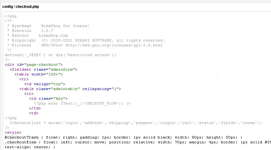

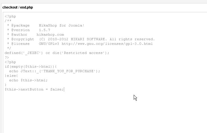

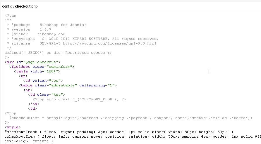

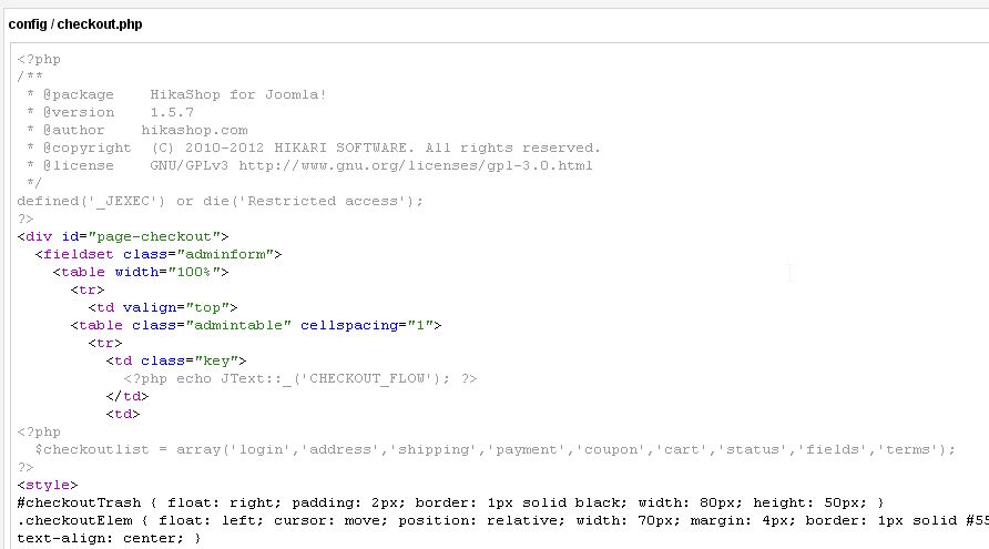

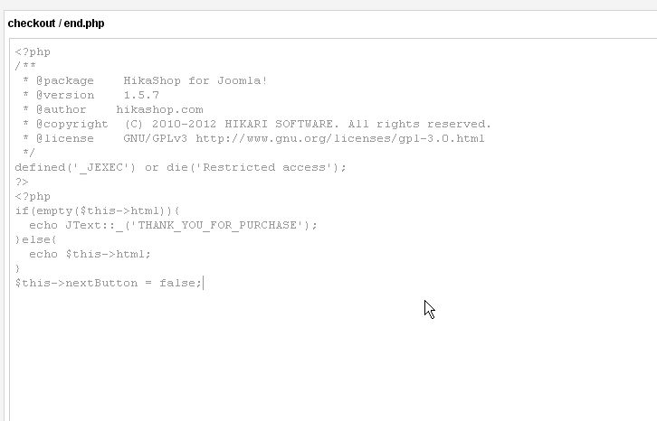

  • Posts: 48
14 years 4 months ago #47295
do you mean this file.
and if so, do i have to add the code at the bottom.
i think its this file, i changed it, but nothing to see at the checkout screen.
Last edit: 14 years 4 months ago by guido.
