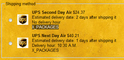

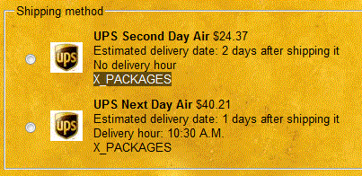

I decided to try out this latest version of the plugin and I am getting a strange result.
Under the delivery hour, it is displaying "X_PACKAGES".

13 years 11 months ago #61757
It's the translation word which enable your group package function to say how many package will be sent, so you'll just have to add this translation word in your english translation file :
X_PACKAGES = "%s package(s)"
