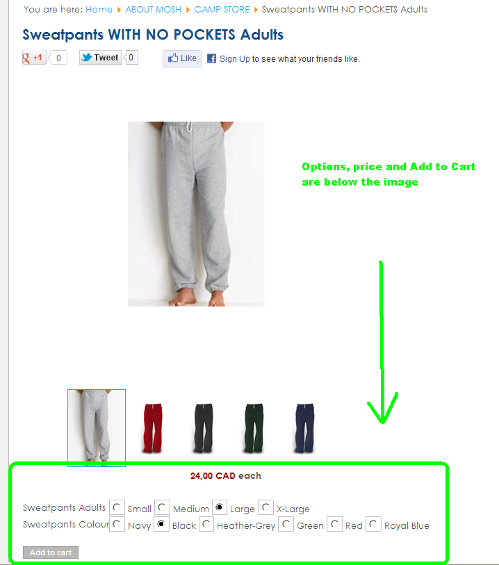

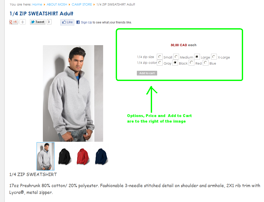

Hi All
Can someone tell me why sometimes the "options" , "price" and "Add to Cart" are below the image and, sometime they are to the right.
In the admin the products are set up in the same manner.
Thank You.

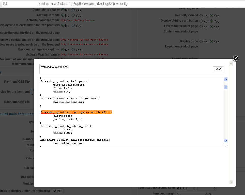

14 years 4 months ago #48944
Once more thank you for your fast reply.
My question is when editing the CSS via the Display tab of the configuration,
as per the attached image, is the highlighted line the correct location to add
.hikashop_product_right_part{ width 45%; }
Thank you
  • Posts: 86177
  • Thank you received: 14212
14 years 4 months ago #48994
That modification is not correct. You should add the line of code I gave you at the top or at the beginning of the file.
  • Posts: 179
  • Thank you received: 17
14 years 4 months ago #49012
I think it should be :
.hikashop_product_right_part{ width: 45%; }
If Im correct a colon was missing, but besides that, dont worry about there being two declarations of the type .hikashop_product_right_part on the css file, they will integrate quite happily, it is easier for you to put it at the top of the file so you can see you modifications you have made in this instance.
