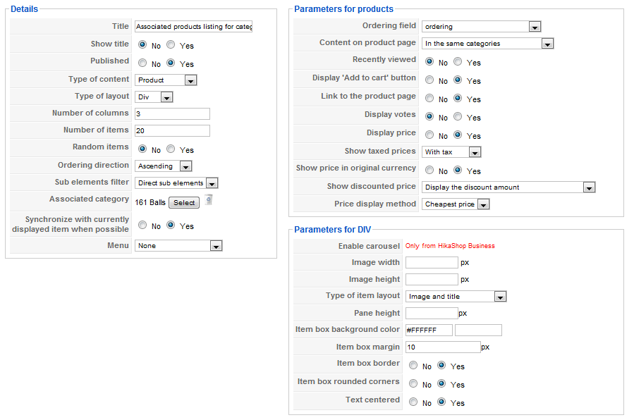

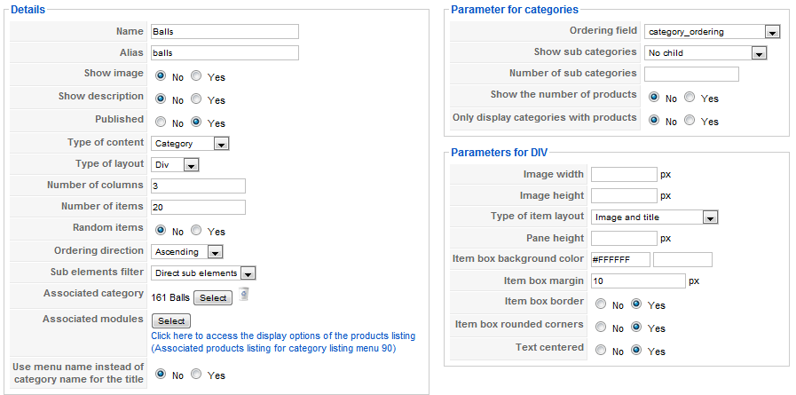

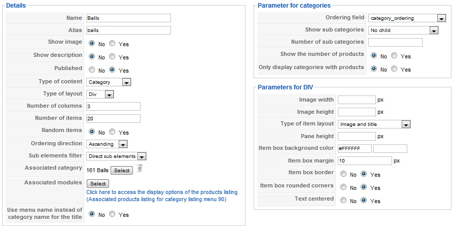

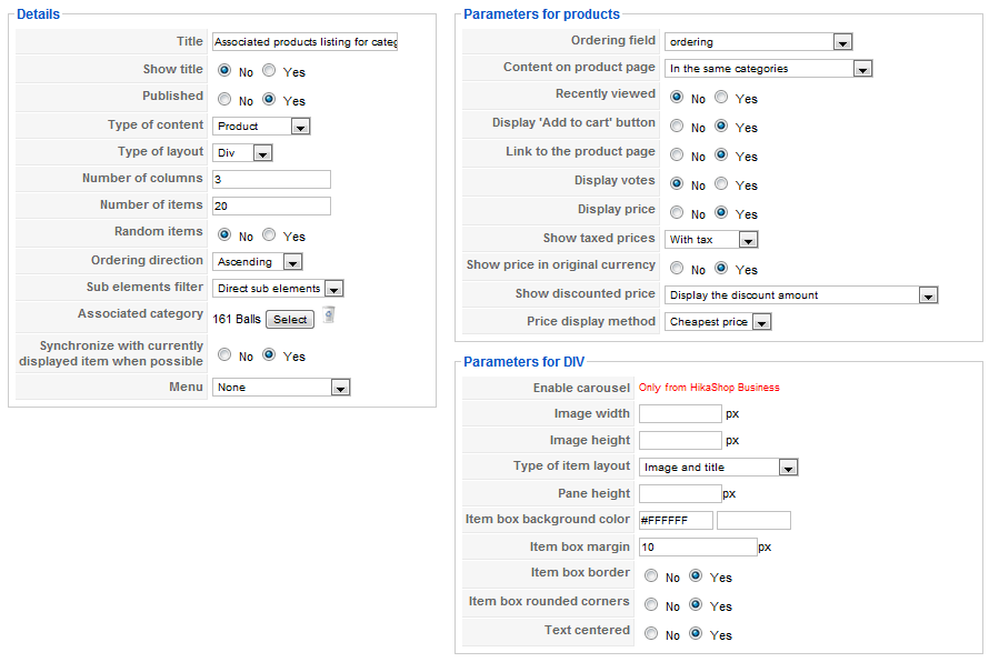

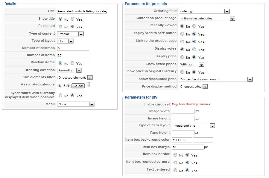

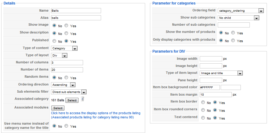

14 years 4 months ago #49274
Thanks, Nicolas. Menu and module screenshots attached.
  • Posts: 86177
  • Thank you received: 14212
14 years 4 months ago #49305
These are the screenshots of the options for the menu which is working. I'm talking about the options of the menu which isn't working.
