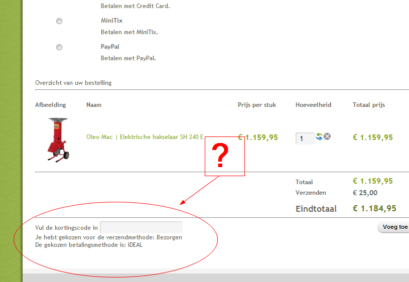

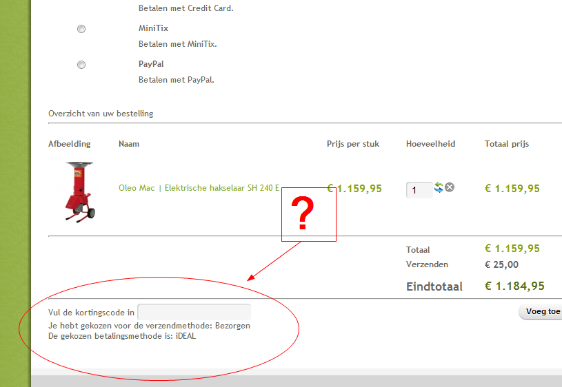

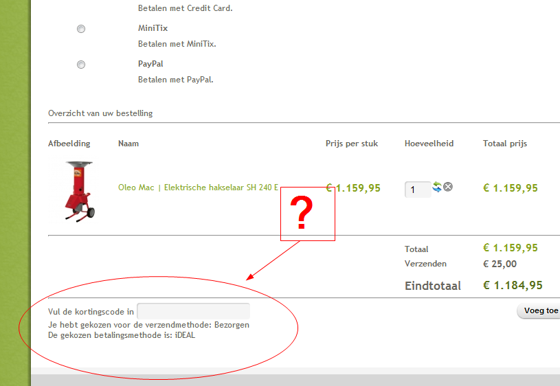

When in your order process, there is this summary of your order. I've found the code in checkout cart.php
But what I can't find is the code direct beneath this summary... See my screenshot. Any idea where to find this code?
Marco

14 years 4 months ago #49247
Thanks... but that's the code for within the summary of the total order.
I'm looking for the DIV hikashop_checkout_coupon
:blush:
14 years 4 months ago #49255
Ok,
I think you should go to components\com_hikashop\views\checkout\tmpl and you'll find the "coupon.php" file that allow you to display the hikashop_checkout_coupon.
UPDATE
for the coupon.php :
- in your back end go to "hikashop -> Display -> Views"
- edit the file coupon of the view checkout
for the payment shipping method :
- edit the file status of the view checkout
like this you can directly edit your view through the back end.
