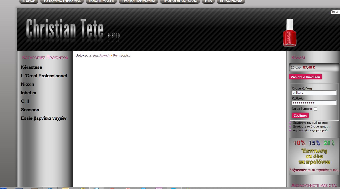

  • Posts: 36
13 years 6 months ago #92110
Hi, I have a similar problem. My option is "Always stay on the same page" and when I press the Add to card button sends me to this url: christiantete-eshop.gr/hikashop-menu-for...g/product/updatecart and its an empty page. Please help.

  • Posts: 36
13 years 5 months ago #95388
Hi again,
the problem is back. You can check it yourself if you want by clicking this link:
christiantete-eshop.gr/hikashop-menu-for...ory/29-initialiste-1
when I am clicking the add to card button it sends me to an empty page.
Also I have a problem with the styling of the popup window. I read a post but it does'nt helped me.
