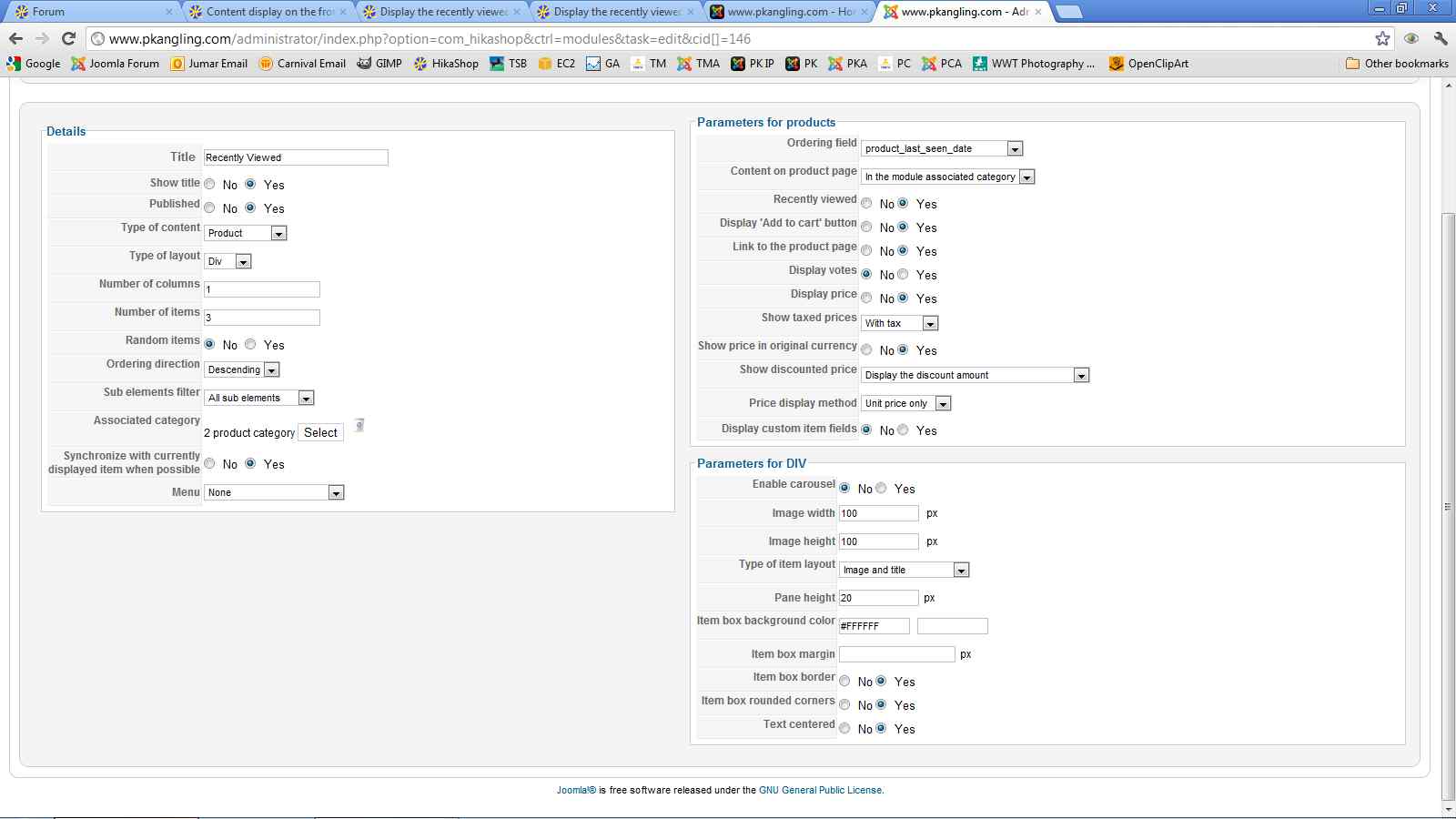

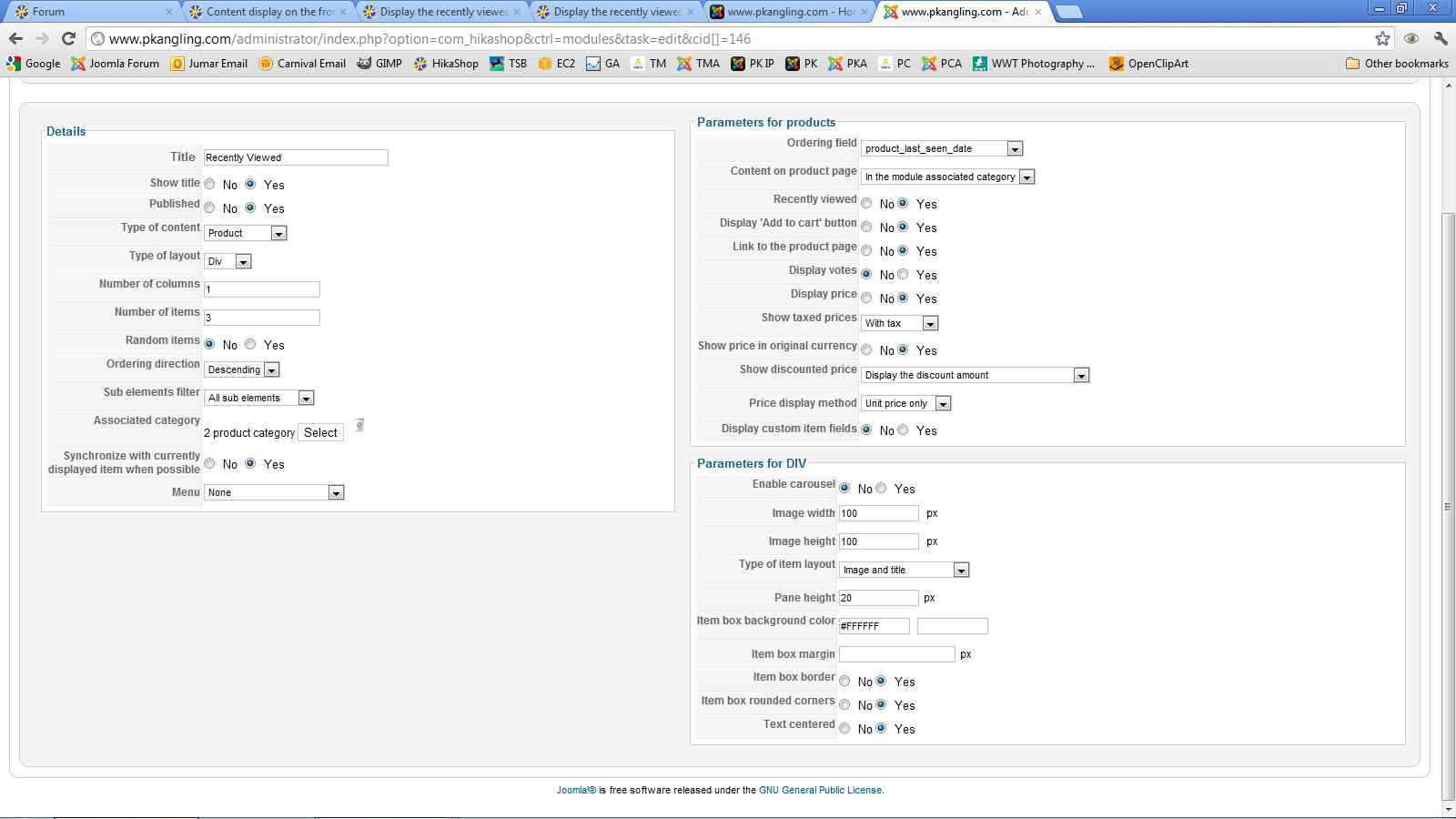

This thread made me test that the Recently Viewed option was working correctly. It's not :unsure:
It seems to be showing recently viewed for all visitors not the individual user.
HS 1.5.7.
I've attached my module settings.
What am I doing wrong?
Tony
  • Posts: 86058
  • Thank you received: 14181
14 years 1 month ago #56757
The synchronization option needs to be turned off in your module for the recently viewed items to be displayed by the module. Otherwise, it synschronizes on the current category/current product/associated category in order to display the products.
Also, there was an issue with it in previous versions of HikaShop so you might need to update to the latest version if you have a problem with it with the synchronization turned off
