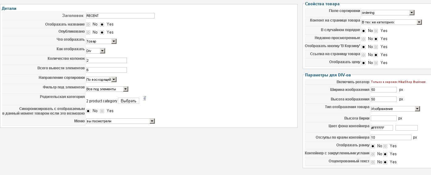

hi Nicolas, finally im stuck with something in HikaShop - cant figure out what options exactly should i set for module to display list of recently viewed items. now it displays some items but they seem unrelated to current session.
joomla 2.5.1 / hikashop 1.5.6 Starter

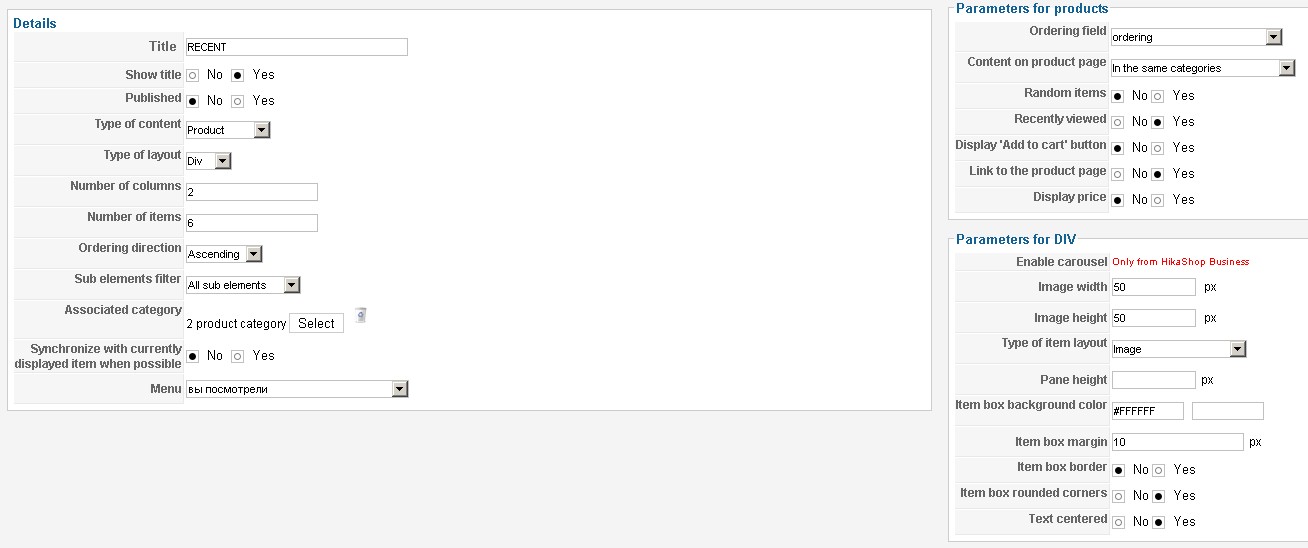

Please do a screenshot of the hikashop options of your module.

i kinda have russian language override :x

Can you logout and login your backend in english ?

  • Posts: 6
14 years 3 months ago #51430
sorry for that, took some time to replace ini back.
