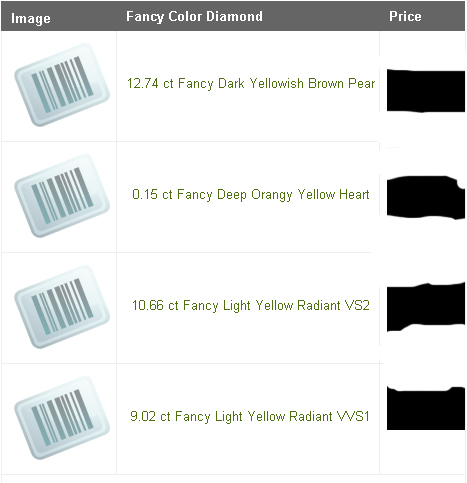

I would like:
1) To have several columns that display custom-field attributes of the product instead of just three columns.
Per the picture above, I would like to have four additional columns, Carat Weight, Color, Shape, and Clarity in the product display table as opposed to having all those attributes in one column.
2) Make it so clicking on the title of the column will sort between ascending and descending.
Thank you,
Jason

1. You will have to edit the file "listing_table" of the view "product" via the menu Display->Views and change the code there in order to add your columns. Custom product field data can be displayed easily like that:
<?php echo $this->row->COLUMN_NAME; ?>
where COLUMN_NAME is the name of the column of the custom product field.
2. You can do that at the same place. If you're not familiar with Joomla php coding, it's a lot harder than point 1 though.
