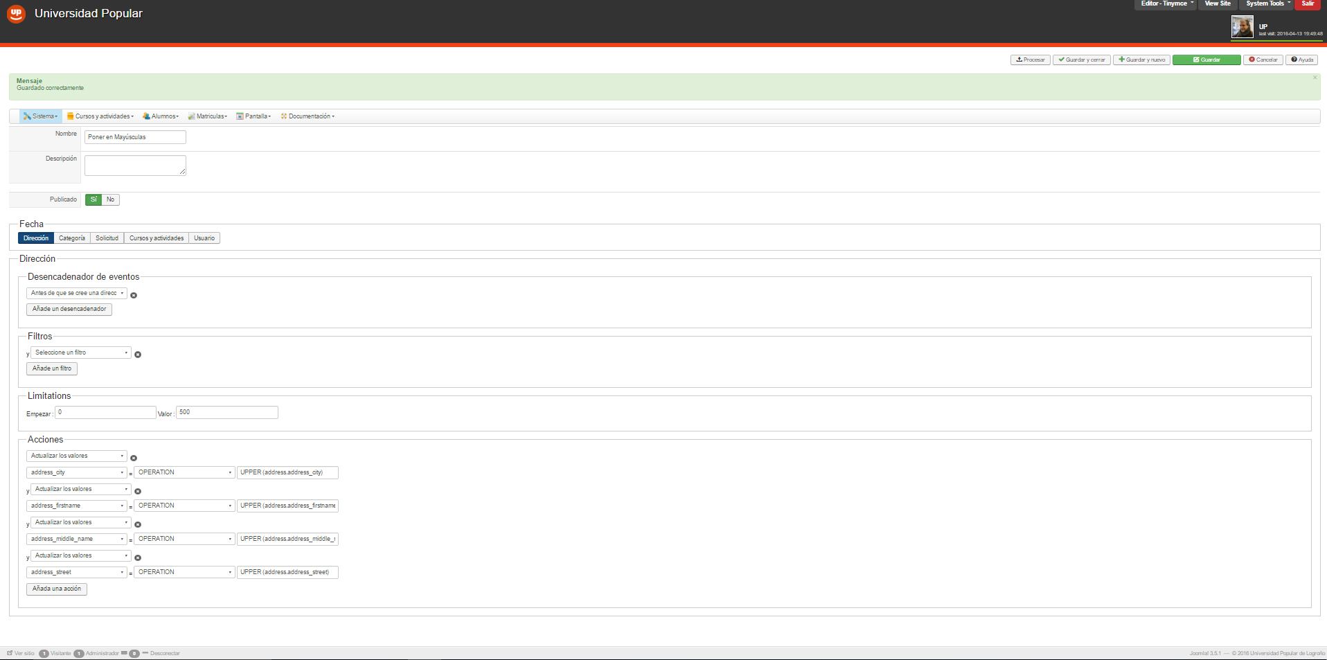

Thank you, but I want the name and adrees , also sent in case the server.
No where to place : strtoupper , if that is the correct method .

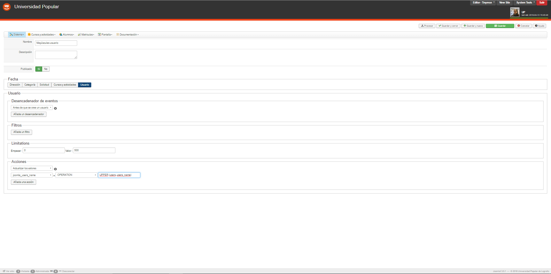

  • Posts: 86104
  • Thank you received: 14203
10 years 4 months ago #236049
Then it's not a validation you want but an action.
In that case, I would recommend to try with mass actions like this :
take.ms/18rGX
You can configure them via the menu System>Mass actions.
The following user(s) said Thank You: dvddvd
  • Posts: 267
  • Thank you received: 5
10 years 4 months ago #236116
Thanks is the solution I was looking for !!!!

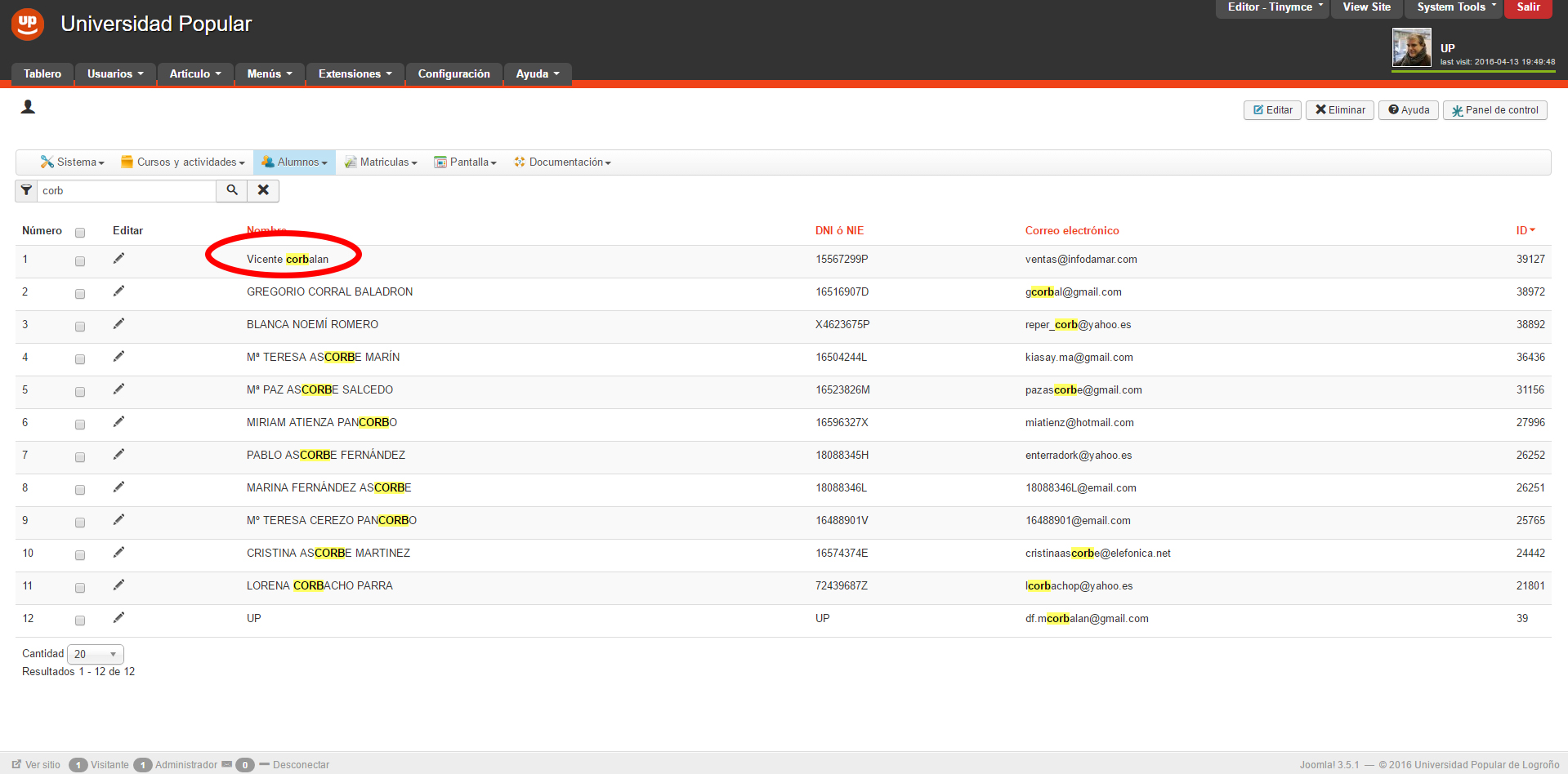

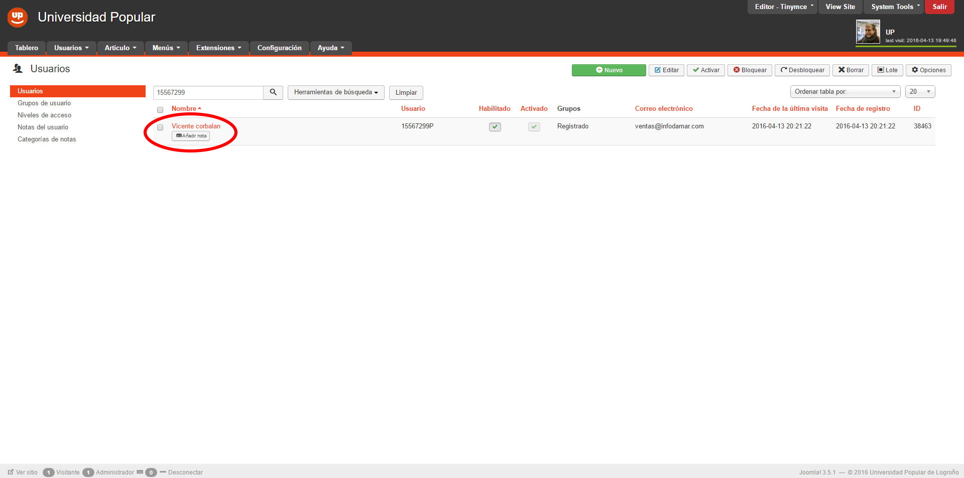

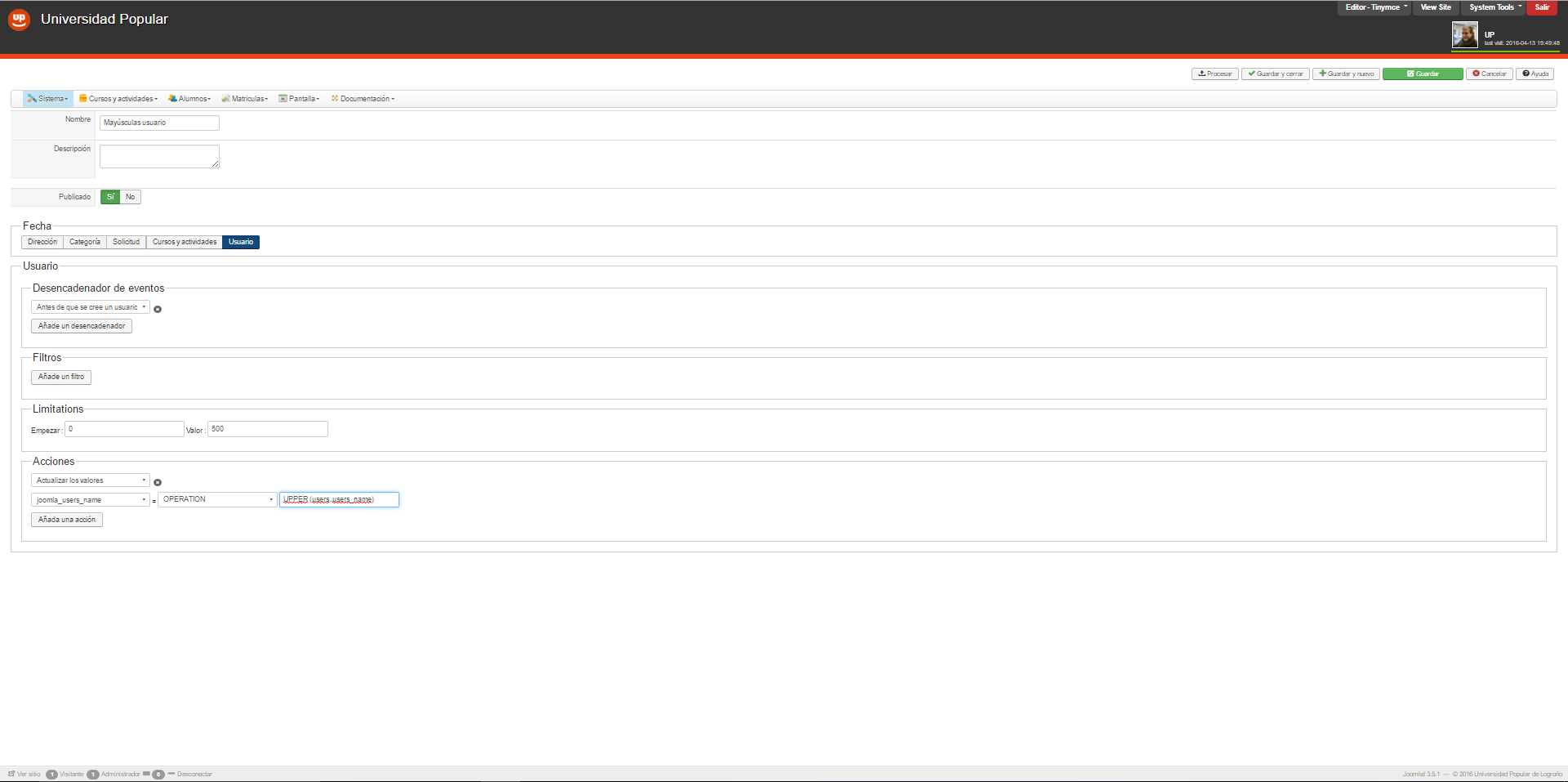

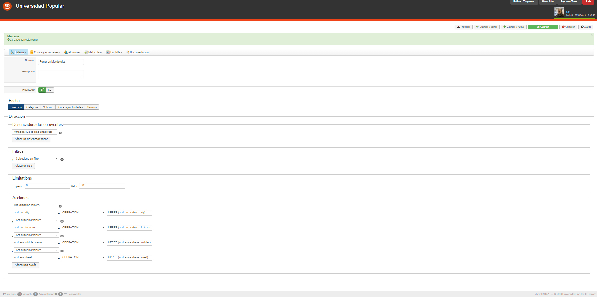

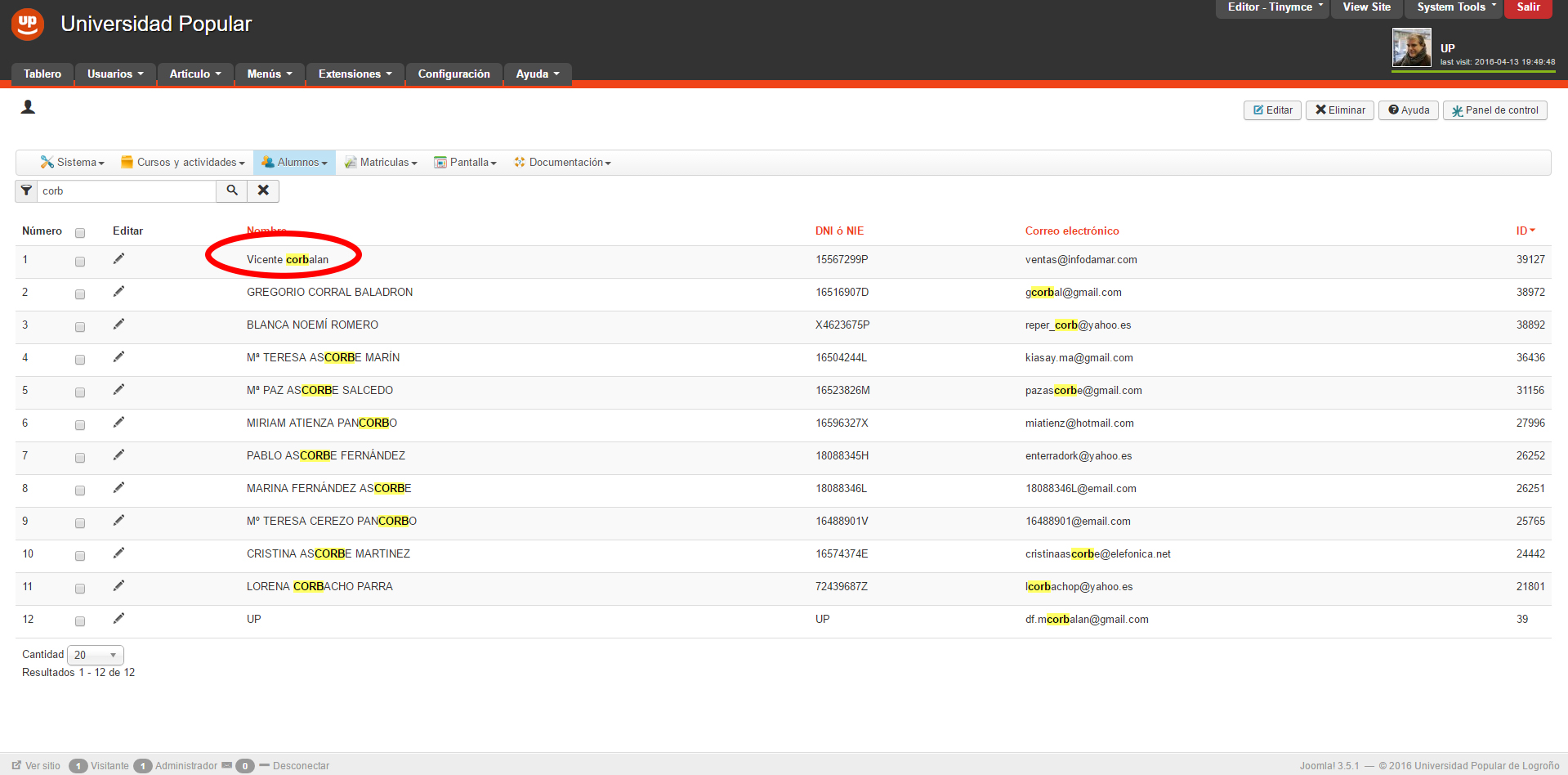

  • Posts: 267
10 years 4 months ago #236594
Hello Nicolas,
I tried to apply the solution you've given me .
But I do not get it to work .
Greetings,
David
Last edit: 10 years 4 months ago by dvddvd.
10 years 4 months ago #236692
I just tried on my local and the address is correctly edited via the mass action with the same setup than you.
Just to be sure, the used trigger is "after an address is created" right ? If not, so that's the issue. ;)
