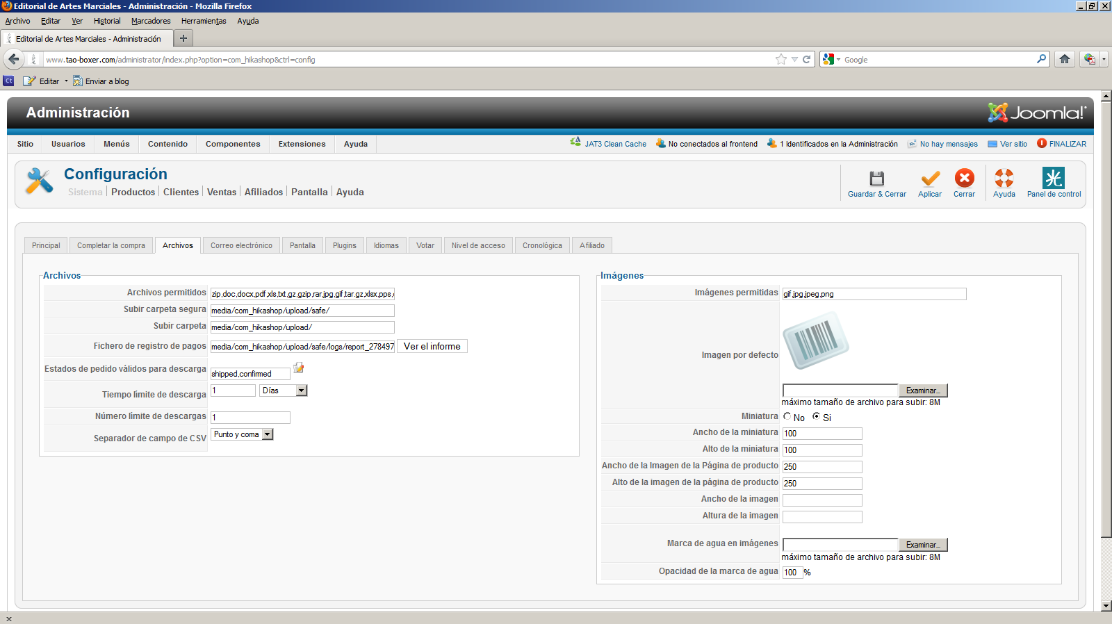

  • Posts: 6
14 years 3 months ago #50927
I attached screenshot of the options.
I not edited anyone views, and the last version are installed.
What has puzzled me is that in the other options, the thumbnails are displayed perfectly.
  • Posts: 86177
  • Thank you received: 14212
14 years 3 months ago #51055
Can you give a link of your product page so that we can see that ?
  • Posts: 86177
14 years 3 months ago #51305
Just add that CSS in the front end CSS file of HikaShop via the Display tab of the configuration and it should work:
.hikashop_child_image{ height: 100px; }
